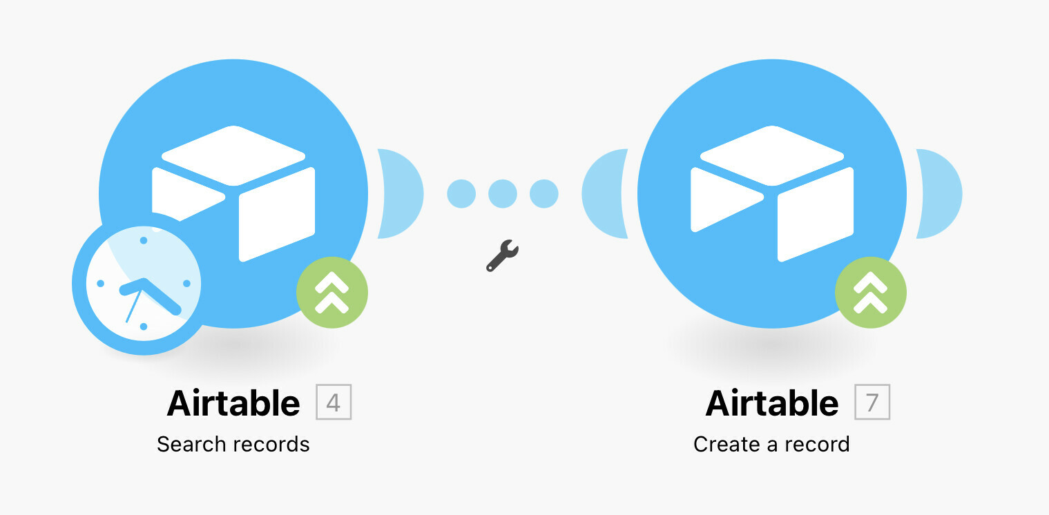

Unfortunately, that is not possible in Airtable unless you know JavaScript and write your own JavaScript code to do that (or hire one of the JavaScript experts in this forum to write the code for you).
This is, unfortunately, one of the many flaws of Airtable.
However, you can automate this with no coding at all using Make.com. It’s as simple as this screenshot below:

Hello Scott thank you very much for your help! Do you know if this is possible in Make if I am unsure how many records there will be? For example, some runs there may be 3 records to copy and some runs there may be 6, it just depends. Thanks again!
Yes, that’s how it works.
