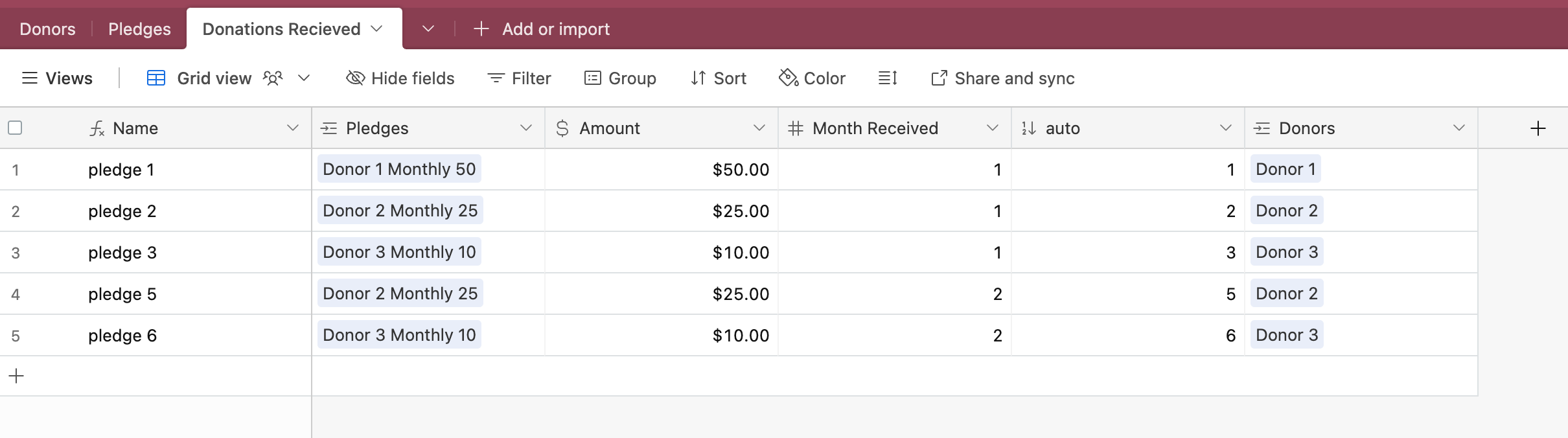

In this example, you can see that data from Donations Received table are "rolled up" and shown in the donor table.
In your use case your form would create data in table 1 then linked to table 2 where you could "lookup" or "rollup" data in table 2.

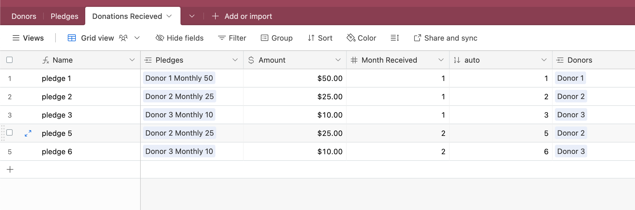

Using a linked table you can use a lookup or rollup field to present the data in the other table.

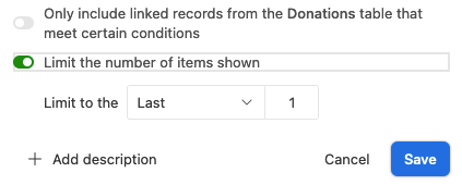

Adding on the Dan's answer, once they're linked and you've added the lookup field, you could just limit the number of items shown to the last 1 so it's always displaying the data from the new record?
