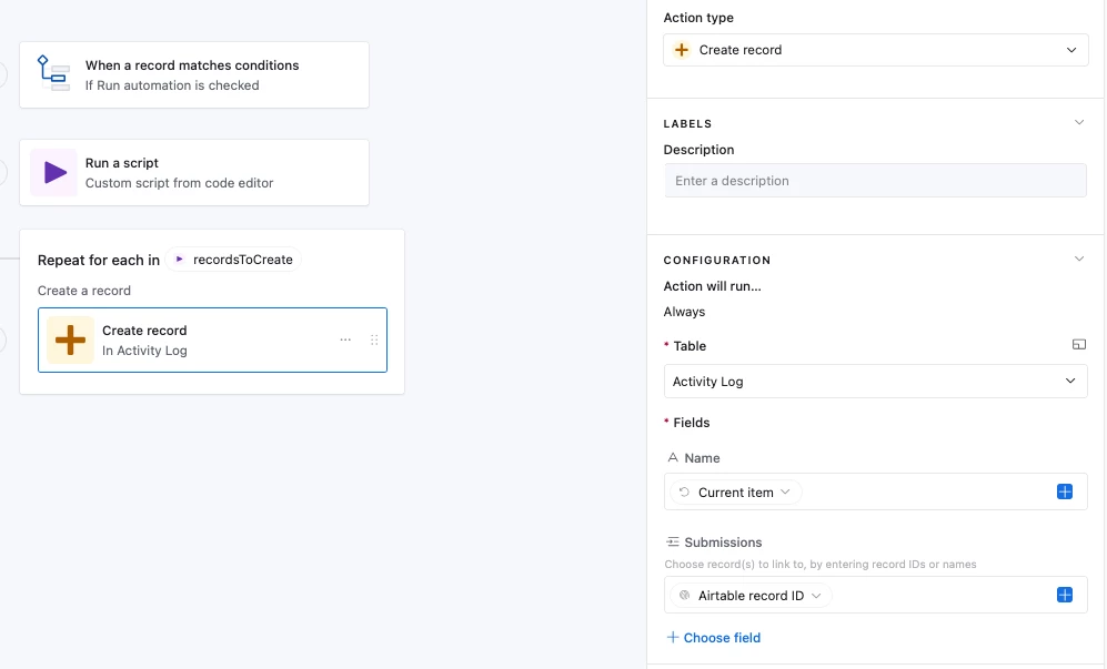

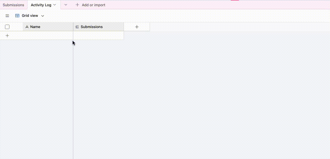

Does this look right?  If so I’ve set it up here for you to check out!  You can duplicate it into your own workspace and play with the settings there too
The idea is to use a script to grab data from each of the fields you want and then output them as an array.  We then use a Repeating Group to create one record in ‘Activity Log’ per field value, linked to the original record
 Automation setup:
In the script below you’ll need to customize it by filling in your table name and field names.  Let me know if you have any issues setting it up and I’ll do what I can to help!

What kind of field should the activity log column be set up as?
You’ll need to set this up as a linked field!
