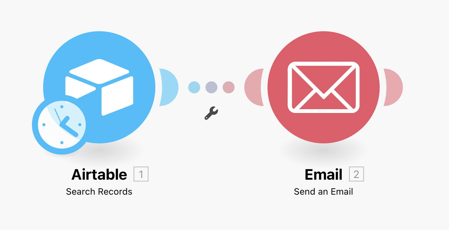

Airtable’s automations don’t allow for looping through found records, so you can’t just search for a group of records and then send individual emails to that group.
You would have to come up with a workaround that tricks Airtable into sending emails to just one record at a time.
There are many different ways of doing this. For example, just a few of the popular ways of doing this are:
  1. Writing a custom script to loop through your found records.
  2. In your case, writing a formula field in Airtable that results in the number 1 when the current day is equal to the day that you specified in that field. Then, your automation would trigger when the formula field is equal to 1.
  3. Creating a utility table that links to your current table, along with 2 automations. This is a popular trick that I describe in this BuiltOnAir podcast episode:
  1. Probably the easiest way to do this would be to use an external automation tool like Make, which gives you both (1) 100% accurate scheduling times, and (2) always loops through found records to send individual emails. Your Make scenario would be as simple as these 2 steps:
