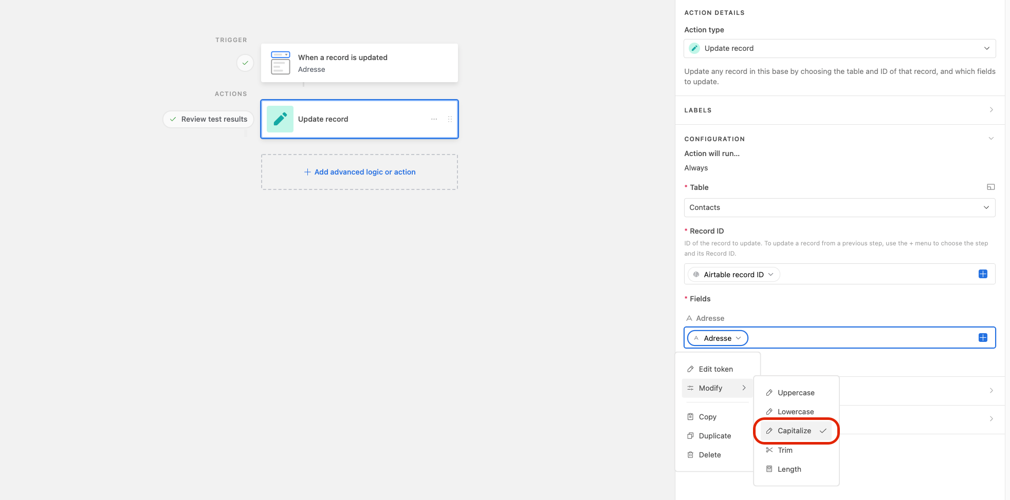

I wanted to capitalize the first letter of every word in my "Address" field, but the automation for that doesn't seem to be working :
I used the exact same automation with Modify > Uppercase and it worked perfectly, but Capitalize doesn't seem to do anything so far. Any ideas or tips ?
Thank you ! 😁
Ah, I believe "Capitalize" only works for the first word in the string.  To achieve what you're looking for, I would suggest creating a formula field with the formula outlined in this post and then using the output in your automation
