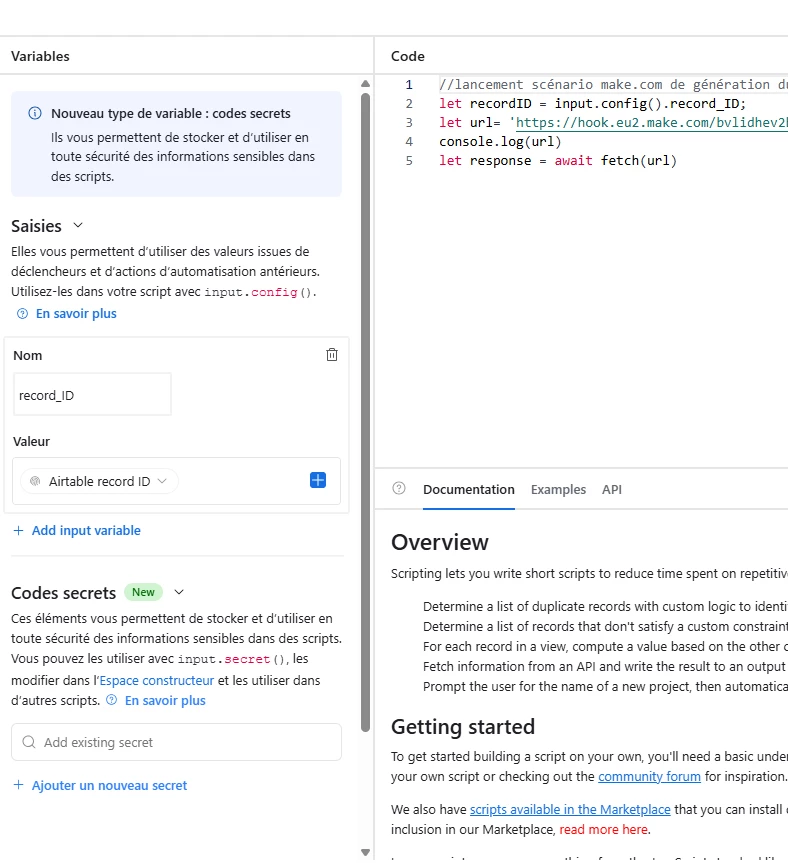

Hello,
Just in case someone arrive here, in between, airtable has released a new feature with secret data that can be stored. It can be accessed within the run a script action in automation.
