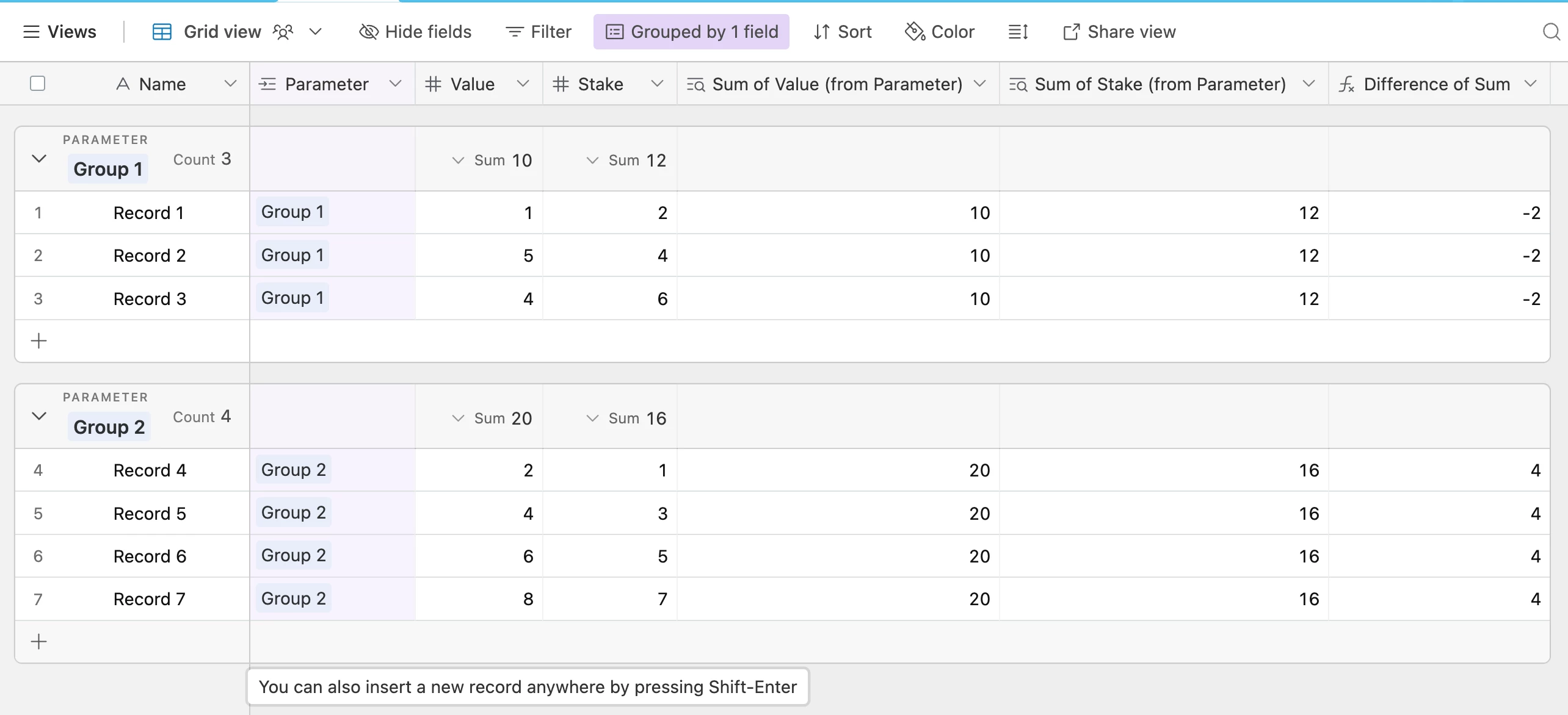

Original Table:

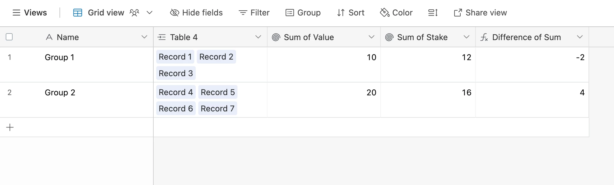

Parameter Table:

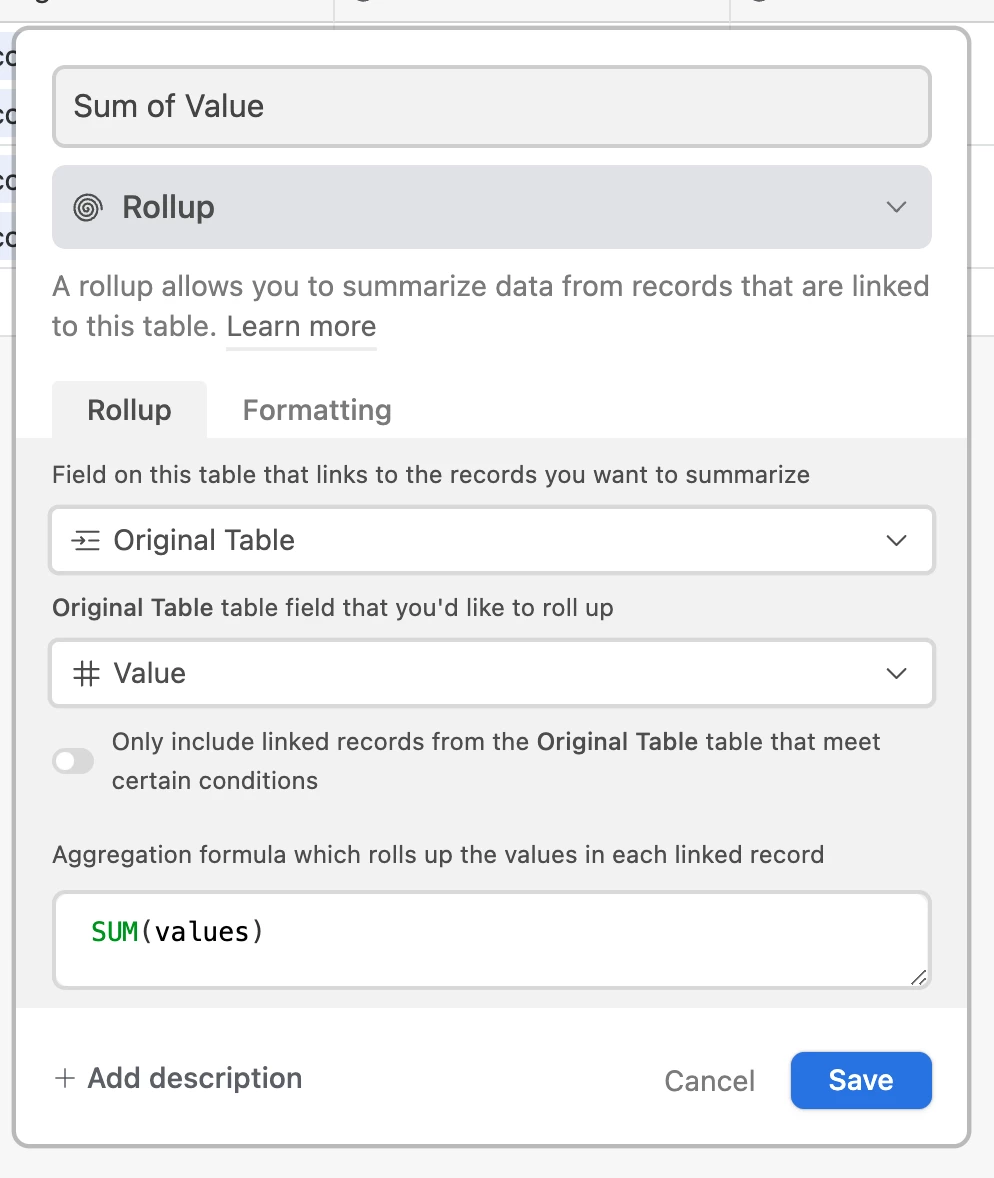

Roll-up field example:

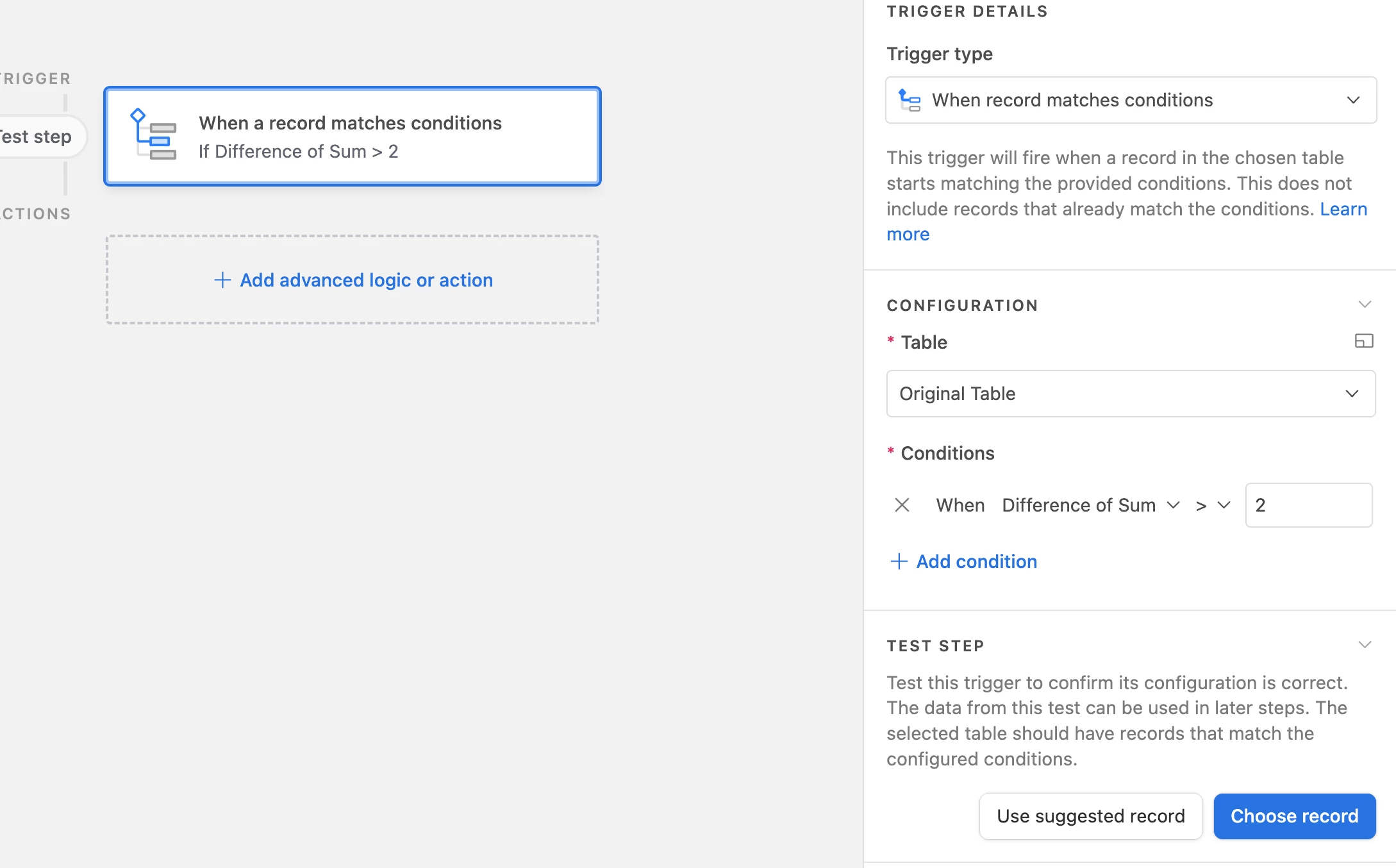

To set up the automation it would look something like the image below where you can set you limit for triggering the action.
Note: depending on the information you need for your automation's action you maybe also be able to set this trigger up from the Parameter table instead. Meaning you wouldn't need the lookups or difference of sum on the Original Table.
