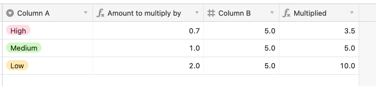

Hi Annie, yeah this is possible
Personally, I would use a formula field with the "SWITCH()" formula to show how much it's multiplying by as it makes things a lot clearer for me, but you could easily do away with it
Link to base.  You can get the formulas by duplicating the base

Hi Adam,
This worked out great!  Thank you so much for the tip!
