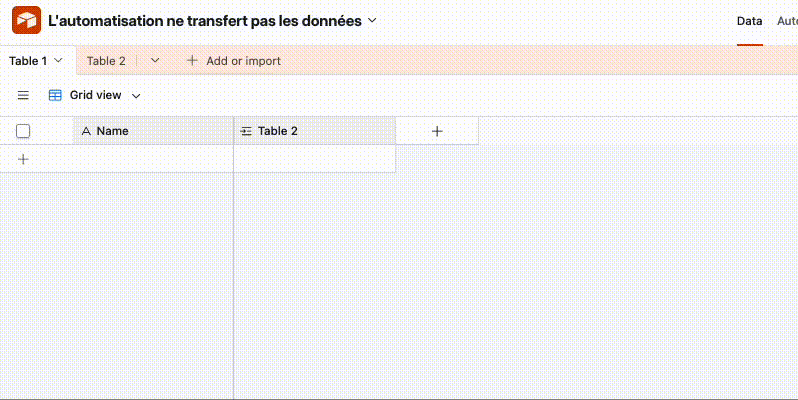

Hm, may I know if records are created in Table 1 via a form or some other automation?  I’m wondering if it’s the following scenario as you mentioned the automation trigger is ‘When record created’:
  1. Record gets created, ‘Name’ field is blank
  2. Automation triggers and creates the new record in Table 2
  3. User enters value into the ‘Name’ field
And so when the automation runs, there’s no Name field to transfer over, does that make sense?
As a workaround, you could try linking the created record to the original record and using a lookup field to display the Name value instead, and I’ve set it up here for you to check out
