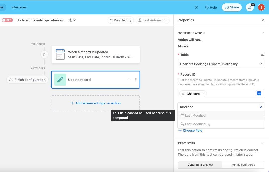

Hi Alessio,
Thanks for your time. As you can see on the screenshot attached, I can't select the Last Update column because it says it is computerised.
