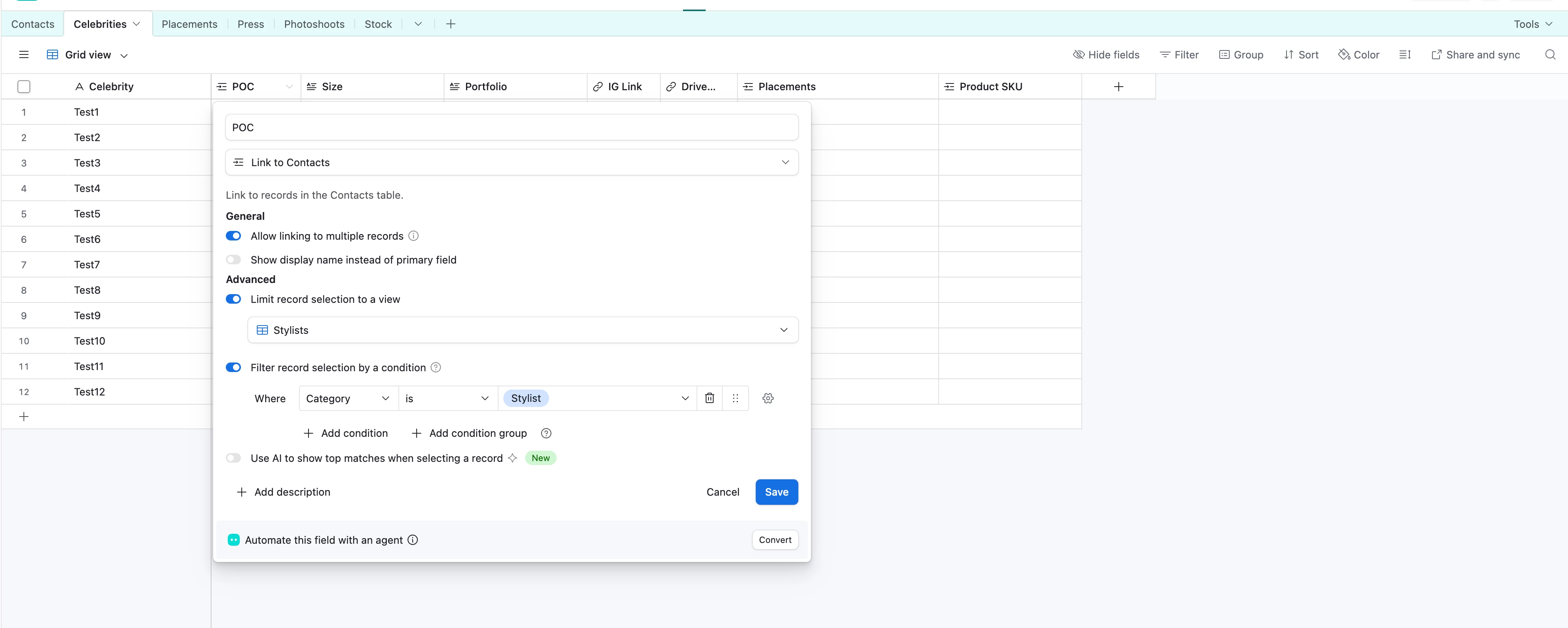

In those tables, I have added a Linked Record column to take the name from the main contacts table, with a condition:
“Filter record selection by a condition
where all of the following condition is true
Where
Category
is
Stylist”
Even with that condition, it’s still pulling the info for all contacts. I even tried to filter by view, to no avail with the same result. Has anyone faced this before?

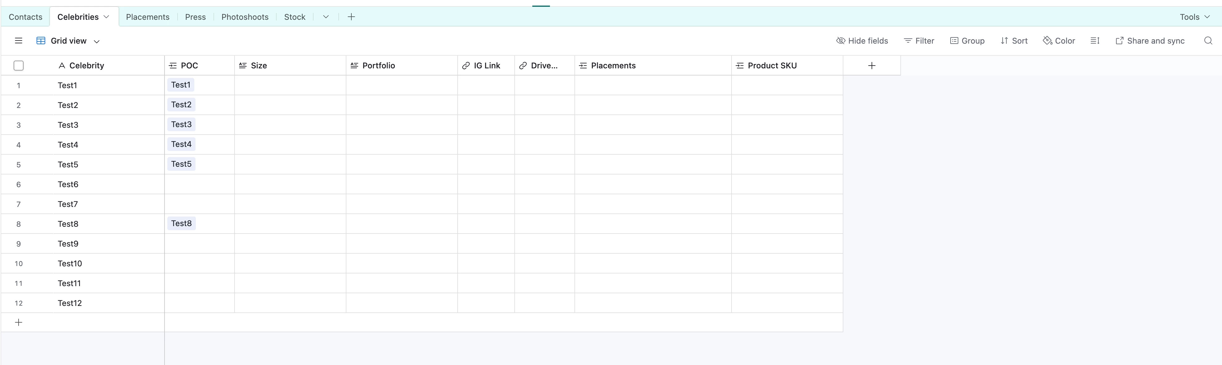

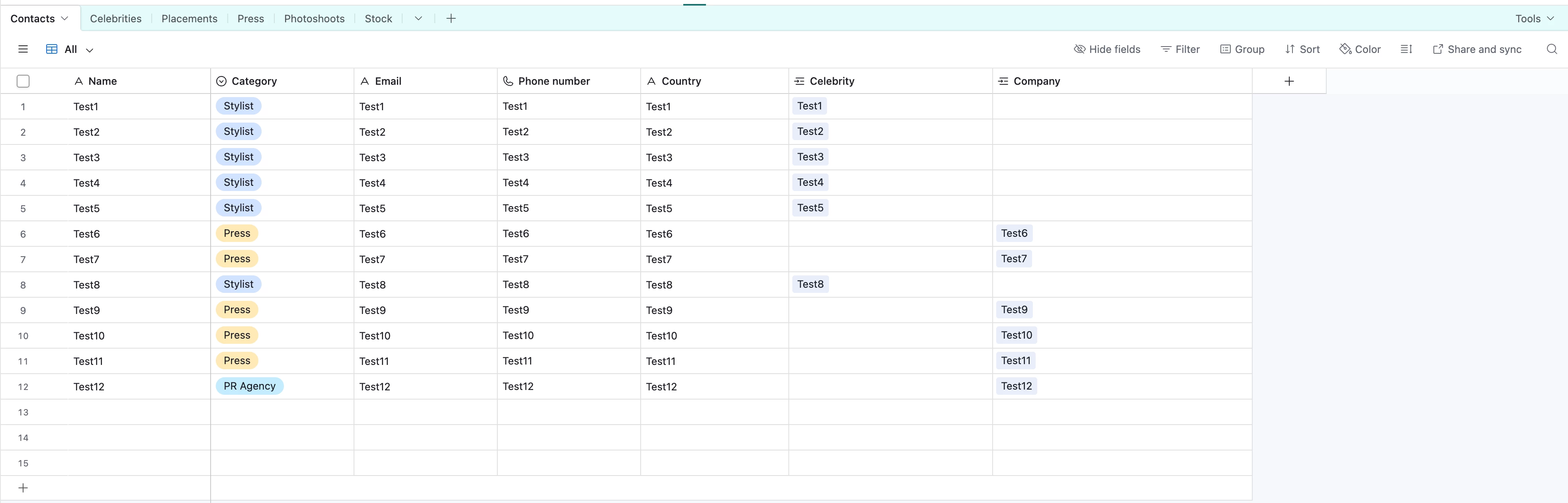

The main contacts table acts as a master sheet for all our contacts while each category of contacts has their own sheet where I can deep dive into details. The structure is actually sound, but maybe I am applying it wrong. I’ve attached screenshots to make it clearer - my only issue now is that the linked record is not adhering to the filtering condition. As you can see, “Test6” is marked as “Press” yet it is still showing up in the “Celebrities” table where I specified a condition where category = stylist

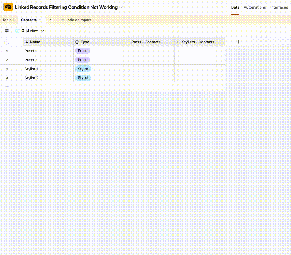

Hm, I’ve set up an example of filtering the linked records here for you to check out
Once we set the filter condition, when we try to link a record it only shows us either the ‘Press’ or ‘Stylist’ records:
Do note that adding a filter to a linked field like this has no effect on data that already exists in the linked field, this functionality only affects the records that are available for selection moving forward
