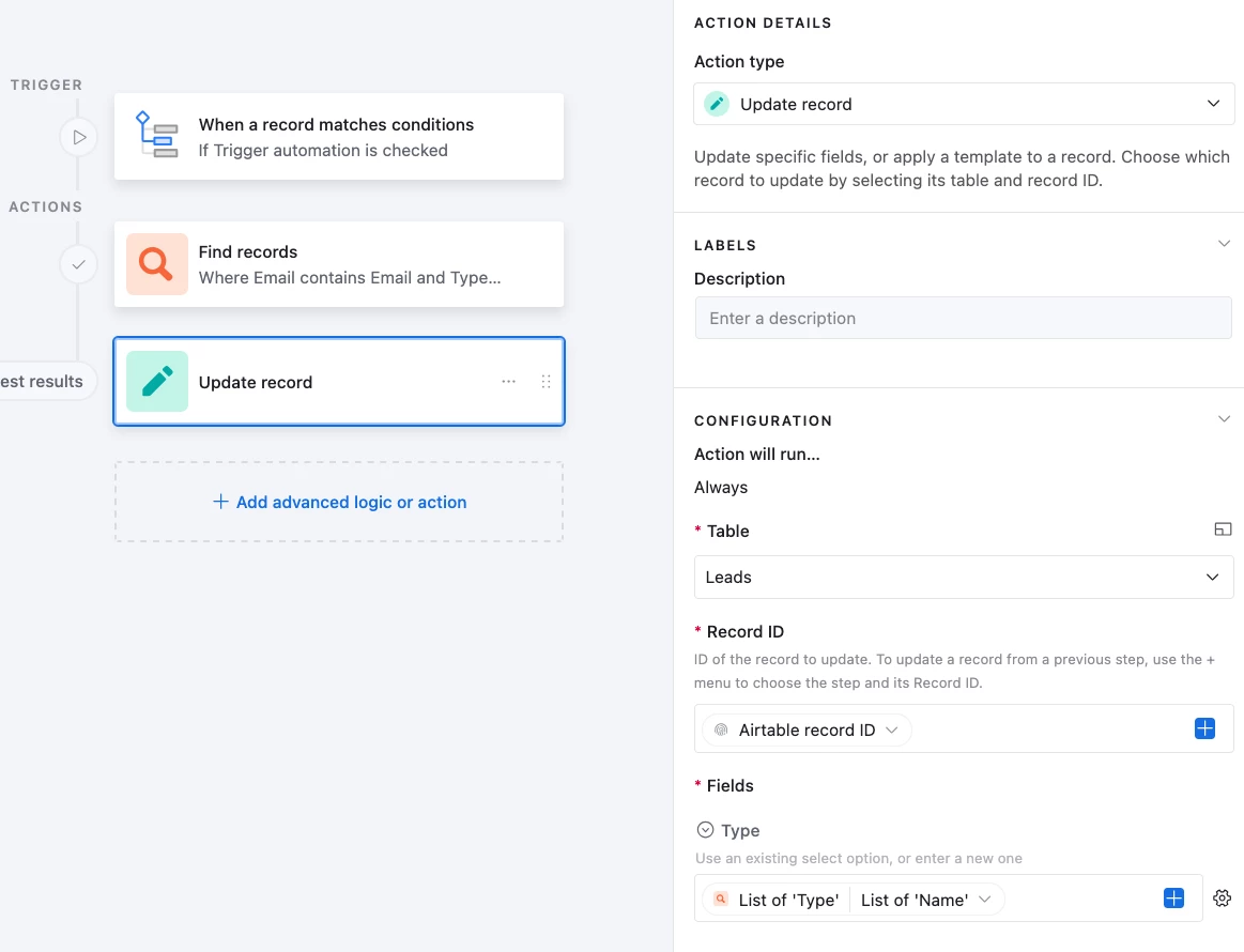

If you're alright with assuming the previous time you tagged it is right, then you could try creating an automation for it:
The 'Find Record' action looks for another entry where the 'Type' is not empty and where the unique value matches.  In this context, it's 'Email', but in yours it would be 'Company'

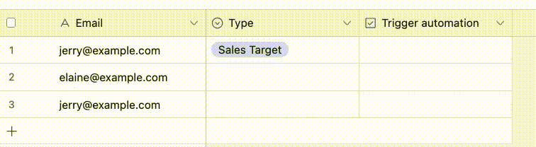

And here it is in action:
