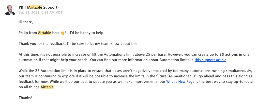

Yes - every client of mine that has asked for a doubling of the limit has been granted this request. Contact support.

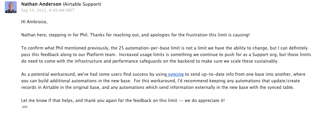

Well, that guy is either lying or misinformed then - as he’s confirmed me the limit cannot be lifted. (or maybe we’d need an Enterprise account, but then he should have told me so)
I asked and was told directly I needed to have an enterprise account for them to raise the limit.
@Bill.French are all those clients enterprise level?
Yes, I believe they are enterprise accounts. But, as Phil said, “he’d be happy to help”, but yet provides no help.

Well, no luck getting more automations for us. But the workaround mentioned is great for some use cases. (using a synced base to run external automations, like sending emails/messages)
