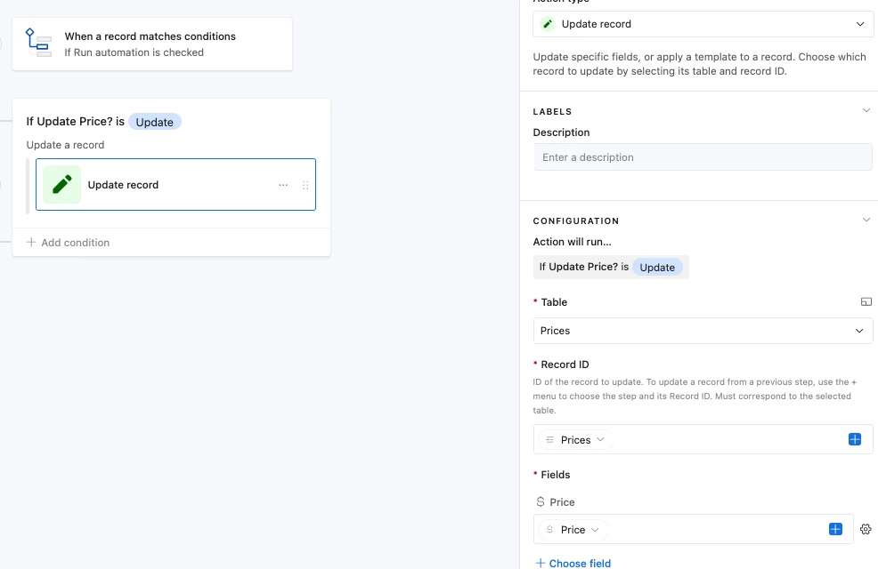

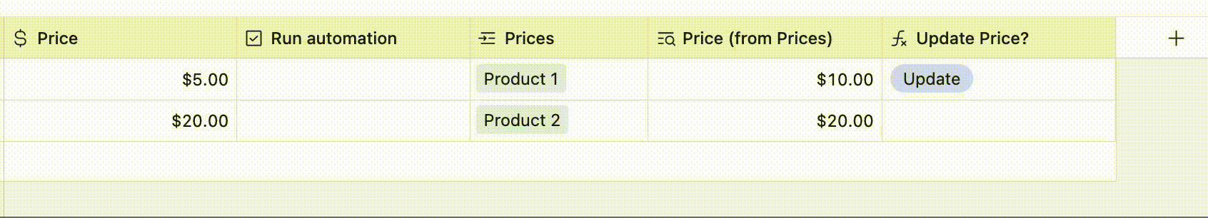

Hm, what if we tried using a formula field to handle some of the logic?  I’ve set something up here for you to check out
We use a lookup field to display the price from the Prices table, and a formula field to check if we need to update it, and the automation has a conditional that checks that
