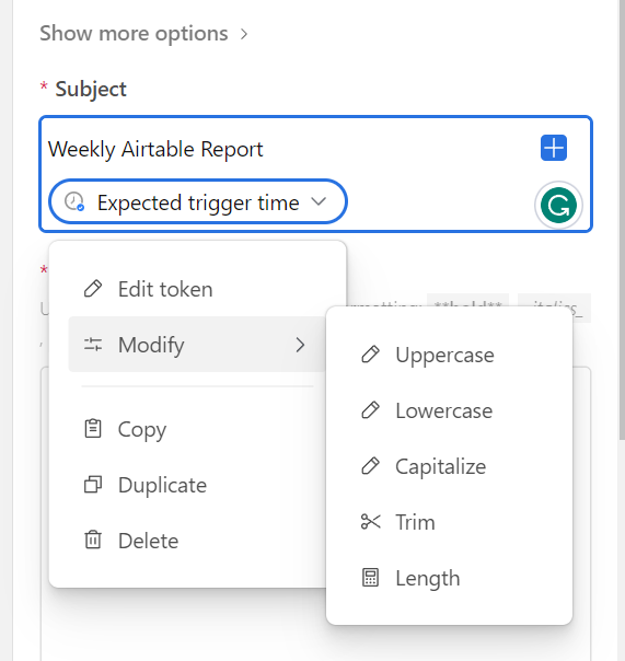

Hi All,

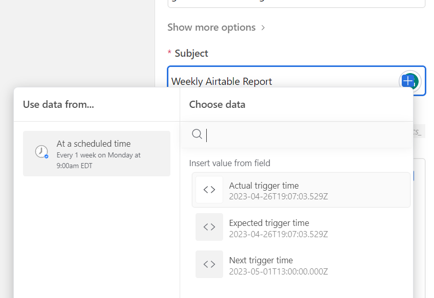

Arranging a weekly report to be sent, but would like to include the Date it was sent in the subject line.
I can select Expected Trigger time as an option:
And when I click on it, I have the option to Edit or Modify the token:
However, beyond that, I don't have a clue how I can make this:
look like this:
Any ideas?
(thanks in advance for the assistance!)

Hi there, I have similar questions regarding sending out "Actual trigger time" in an automated slack message. it returned the whole time string as GrahamW showed. I used to format by using the following syntax :
<!date^timestamp^token_string^optional_link|fallback_text>
while
  • !date indicates the use of special date parsing.
  • timestamp is a number in standard Unix time format, representing the date and time you want to include in your text.
  • token_string provides formatting for your timestamp, using plain text and any of the tokens listed in the original text.
Do appreciate if anyone could offer help how to format the date for "Actual trigger time" or "Expected trigger time". Thank you in advance! 😊

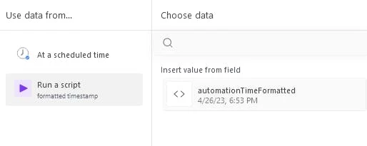

You can use an automation script to produce the date timestamp as a formatted text string. I give a detailed explanation (including full code) here.
Using a script means that you can avoid having a helper field that uses NOW() or TODAY(). Avoiding those formula functions is a good idea anyway because NOW() is notoriously inaccurate. Plus, those functions can slow down your base because they recalculate even when no other data in your base has changed.

Add a scripting action to your automation after the trigger but before where you want to use the formatted date. Then type the script in the scripting editor.
Did you read the full article? It has line by line instructions including where to put that function, and the full code at the end.
