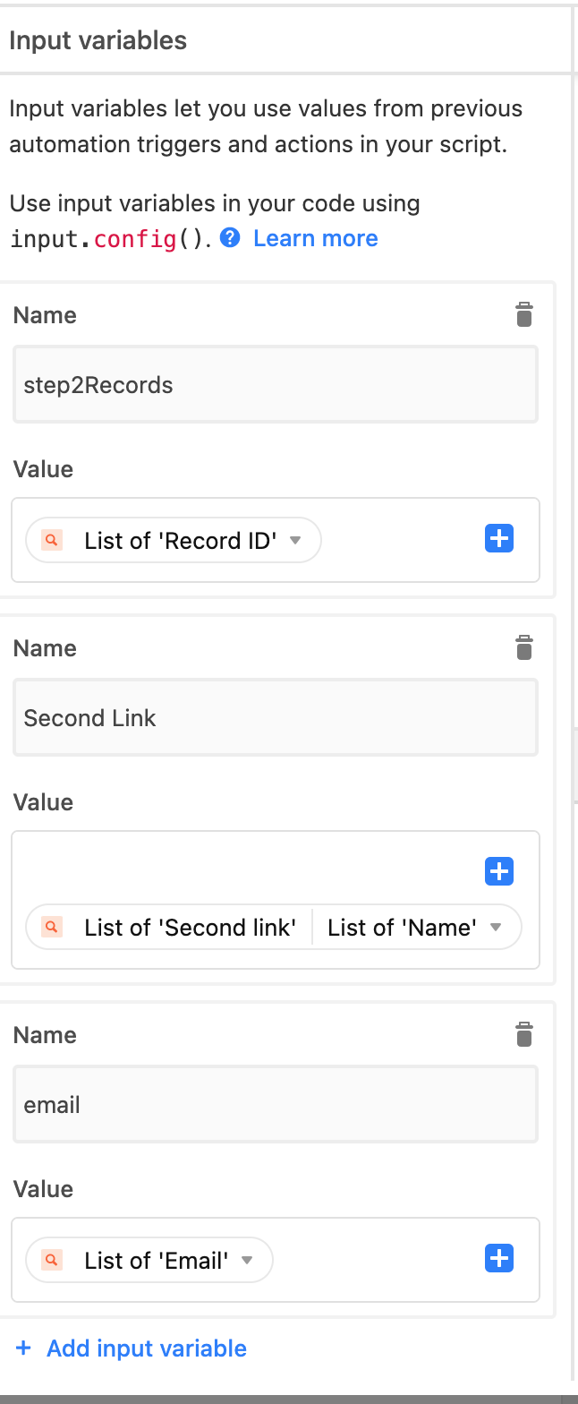

let records = input.config().step2Records let table = base.getTable("Playground"); if ("Email") { for (let record of records) { await table.updateRecordAsync(record, { "Email": "Undefined" }) } }
For reference,  input variables:

 This bit of code is part of your problem. Your "if" condition is testing the hardcoded text string "Email", the literal word "Email", which is always a truthy value. The word "Email" is not the actual email of of a record. You need a variable in there somewhere. Are you trying to get the value of the "email" input variable?
It also looks like you are trying to cross-reference the emails and record IDs in your input variables. I do not recommend doing this. Instead, you should probably
1. Get the records IDs as an input variable.
2. Query for the actual record objects with those record IDs
3. Loop through the actual record objects to get the email values, check for nulls, and perform the updates.

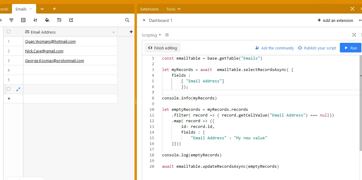

Sometimes it's worth working out the logic in a simpler environment - in that, before trying to get your script working within Automation, try out some logic in the Scripting Extension before hand.
Using the scripting app - I think a working solution may look something like this;
const emailTable = base.getTable("Emails") let myRecords = await emailTable.selectRecordsAsync( { fields : [ "Email Address"] }); console.info(myRecords) let emptyRecords = myRecords.records .filter( record => ( record.getCellValue("Email Address") === null)) .map( record => ({ id: record.id, fields : { "Email Address" : "My new value" }})) console.log(emptyRecords) await emailTable.updateRecordsAsync(emptyRecords)
Importantly, if you are planning on venturing into the land of scripting and all things Javascript, seek an understanding and the .filter() and .map() methods. Unfortunately (and what I found to be very frustrating as I went about learning Airtable Scripting) is that you won't find these techniques used within the API examples - but as soon as you learn and understand them, Airtable scripting becomes far more approachable.
Once you're solving the problem within the Script Extension, you may then migrate your idea into an Automation script.

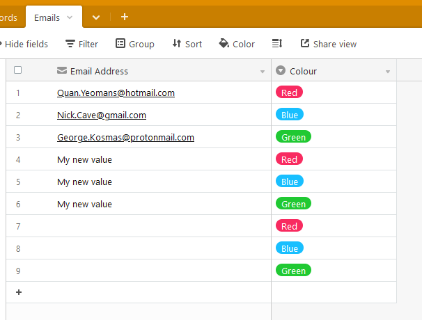

It's a great idea to figure things out in the scripting block before trying it in automation. I think I was intimidated by what I read somewhere that there are some small differences in writing script In Automations vs Scripting and thought just to dive straight into Automations first. But thanks for the pro tip!
You're absolutely right about understanding .filter() and .map() methods and I had a small suspicious it would include something like that, but what you wrote did help clarify some understanding.
The script yo shared worked! If I were to add on to this, where I am doing null checks for multiple fields (Example: If "Name" === null, make "Name= "my new cell value") how I would I add that in this script?

As you've noted, there are differences between an Automation Script vs Extension Script - such as they have an ability to take input from previous Automation Triggers and Automation actions, whilst also able to output to subsequent Automation actions. This gives us multiple ways to get base and record data - through an input, or through a base query - both are just as useful, and there are no doubt scenarios where one method is preferred over the other.
One trick, within automation, is try apply a javascript techneque called Destructuring Assignment on the input object. For example, your Automation inputs of step2Records, Second Link, and emails - with minor alterations we could do something like;
const {step2Records, secondLink, myEmails} = input.config(); console.log(step2Records); console.log(secondLink); console.log(myEmails);
This method assigns the values directly to your named variables in one simple line. I usually can tell when I'm working with my old code, because I always forgot about this in my early days of scripting.

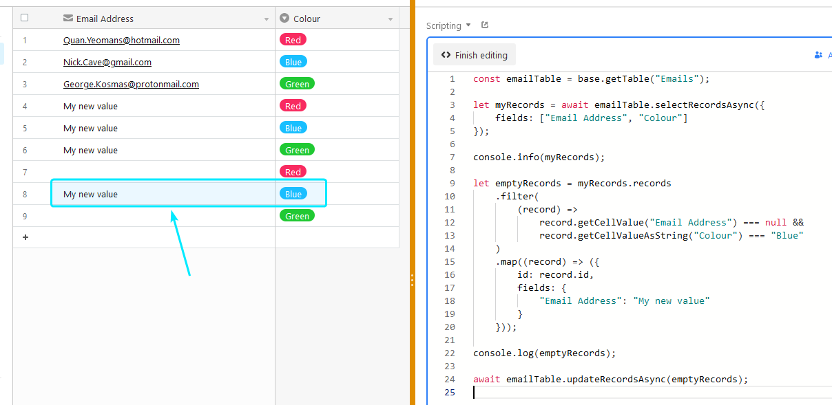

My code snippet below (I hope I don't break the forums... man I miss being able to use emoji!)
const emailTable = base.getTable("Emails"); let myRecords = await emailTable.selectRecordsAsync({ fields: ["Email Address", "Colour"] }); console.info(myRecords); let emptyRecords = myRecords.records .filter( (record) => record.getCellValue("Email Address") === null && record.getCellValueAsString("Colour") === "Blue" ) .map((record) => ({ id: record.id, fields: { "Email Address": "My new value" } })); console.log(emptyRecords); await emailTable.updateRecordsAsync(emptyRecords);
Importantly, we've added more fields to the selectRecordsAsync query, along with updating the filter() with an AND and a second comparison.
