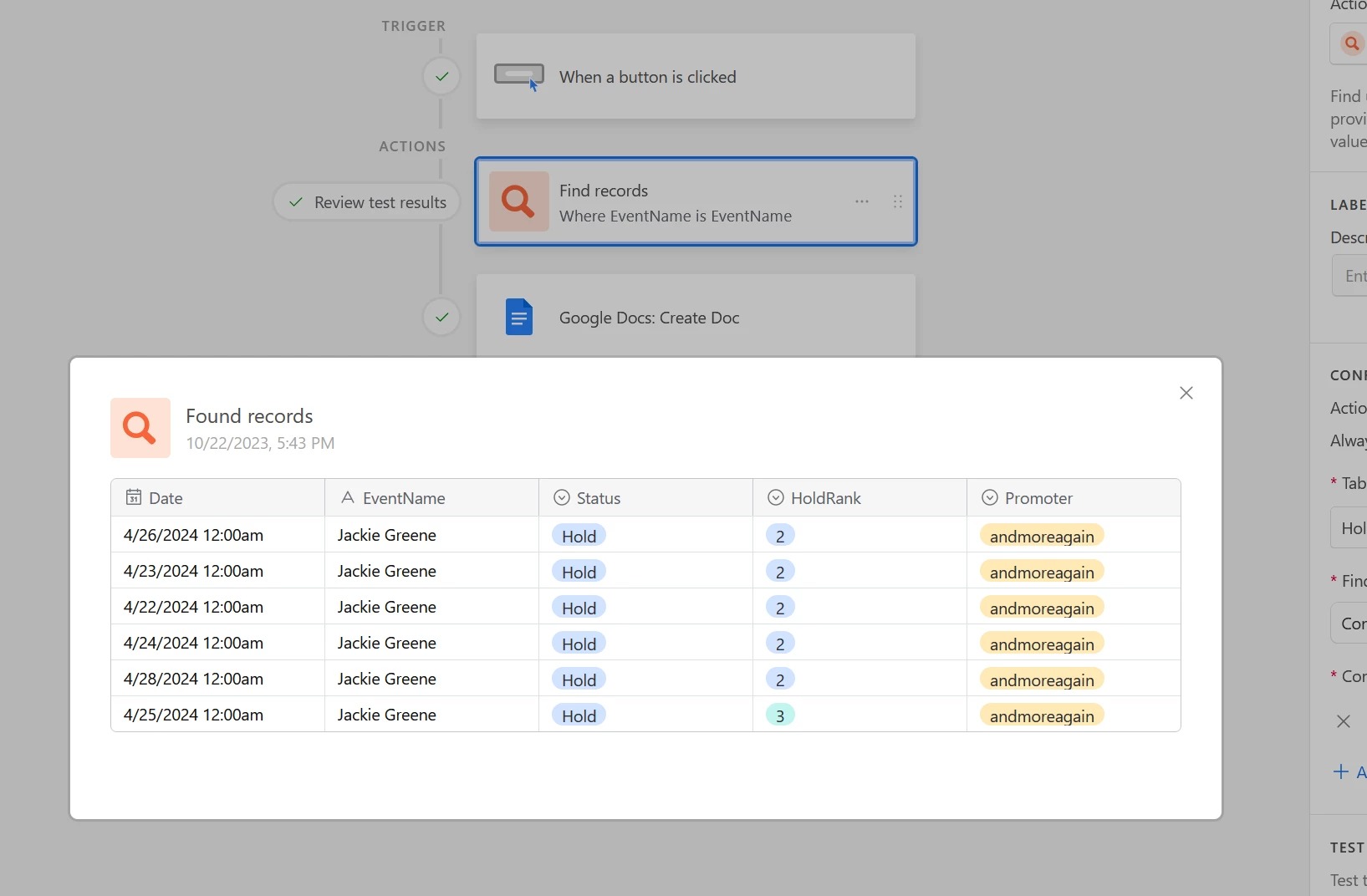

When editing an automation that uses the Find Records module, the "Test Action" function outputs the resulting records in a nice pop up table. How can I get this same functionality with the published interface/automation? If I don't add an output, then initiating the automation from the interface (in my case a button), yields a "Started" notice at the bottom left, but then nothing. I've been able to get the output to go generate a GoogleDoc, but this is cumbersome. I really just need to be able to Copy the text (and paste it into an existing email reply).

But I don't want to send the results as an email. What I want is so much simpler. I just want resulting grid of records to pop up (as text) so I can copy it. Just exactly like you get when testing the automation. I've searched the docs and the forums and etc and it frustratingly seems like this simple thing is just not possible.

To be explicit, the table has: date, name, status. The interface has a Calendar. User clicks on an entry and on the resulting dialog there's a button. The button fires an automation with a Find Records with a dynamic condition on Name field. So it returns on the records that also have that same Name. The user needs to copy this list (of date, name, status) into a document they are composing. To me it all seems VERY simple and I am confounded that in the list of "integrations", airtable lacks a simple "just show the list of records"!?!
