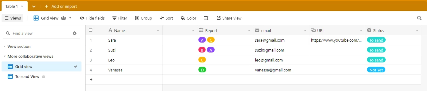

I’m trying to use the script to automate the emails in my database. I’m pretty new in airtable, so I’m trying to figure it out.
This is a fake example of my database:
I want to create a code that sends emails only to people that have the status “To send,” and I would like, for example, Sara will receive 2 emails:

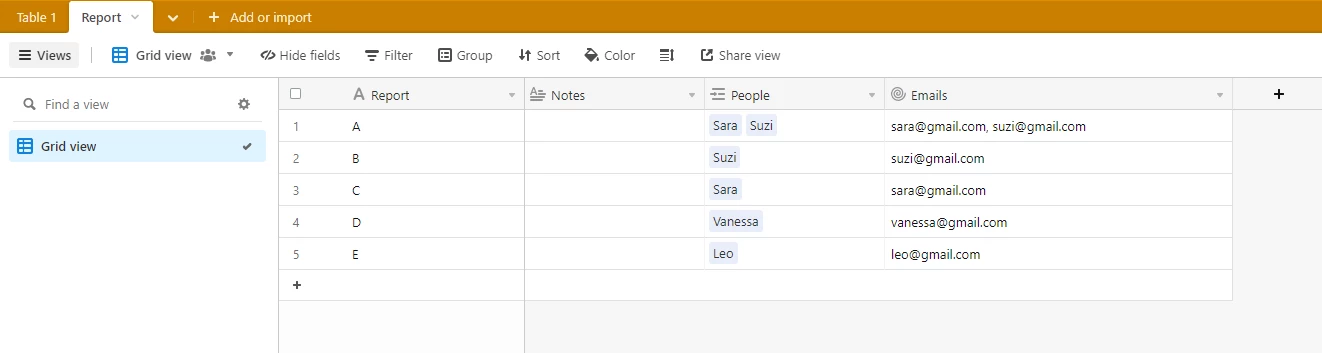

Since you have the Reports already as a Linked Record field, then you should use that in your automation instead. You can use a Rollup “ArrayUnique(values)” or a Lookup to get all the email addresses from the Table 1 (which I assume is a Contacts or Users table) then use this email field to
trigger the emails. Now comes the part of how to start your automation, do you want to send it daily or when something happens? If it’s daily then you can set the trigger as At Scheduled Time.

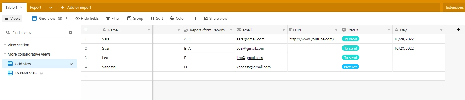

I need emails every 3 days before the deadline (another column I didn’t add to the fake database).
So do you think that I don’t have to use the script? I can have the same results without coding?

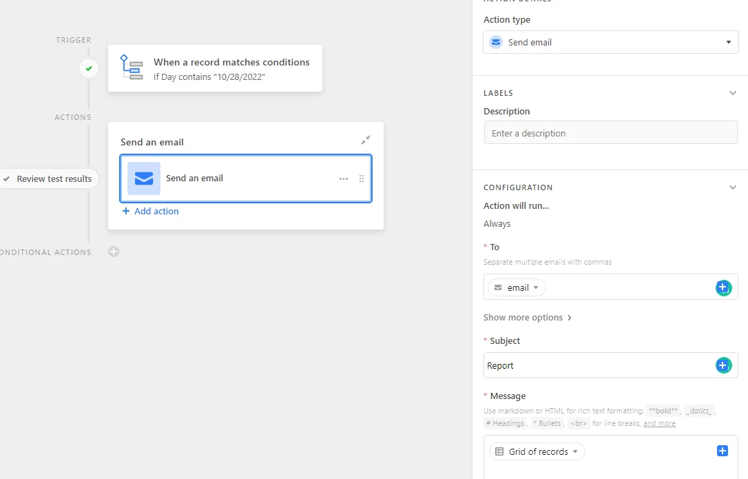

Yes I dont think you will need a script, just the steps in the automation.
If you want to send it every 3 days you can have a formula in one of the fields that would say “Trigger” or something and you can then use it as a condition in your automation instead of the Schedule.

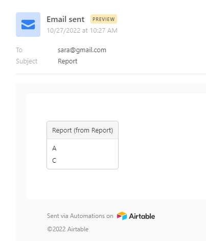

I probably did something wrong… or otherwise, it doesn’t work this method… As you can see, Sara will receive an email with “A” and “C”.
Mohamed_Swella1
Yes, the condition is set in Table 1 instead of Reports table. You need to Rollup the value from Table 1 (probably using Max to get the latest date) into table Reports. THEN use this as the condition so the data will come from Reports table (1 per report) instead of Table 1 (1 per user)
