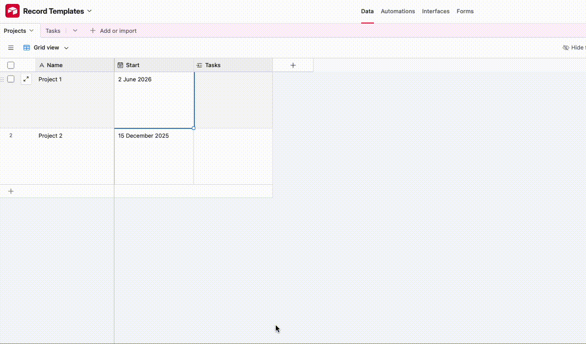

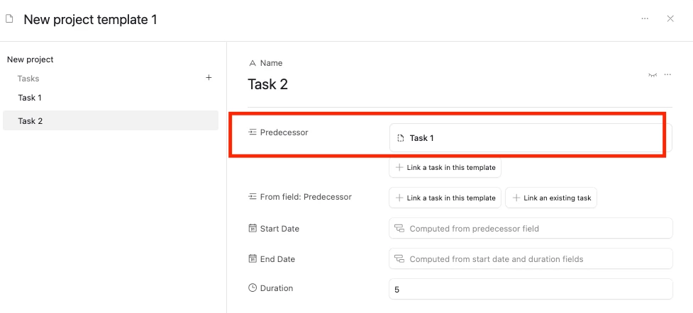

I’d suggest trying to use Record Templates instead if possible, would make the predecessor creation much simpler! https://support.airtable.com/docs/using-record-templates-in-airtable
We set it up within the template itself:
And when applying the template (either by right clicking or via an automation), it gets created for us automatically:
