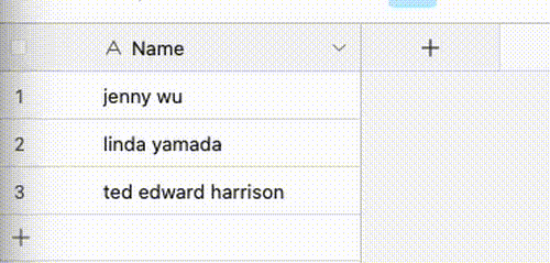

Hey!
Check out this case change script: https://www.lomlabs.io/airtable/scripts/case-change (free to use for 100 runs w/o license key)
use “start case” to capitalize the first letter of each word
Clone this sample base to your workspace if you’d like to test it out: https://airtable.com/invite/l?inviteId=inv1rDjAj9dqqcqwE&inviteToken=38375de0f1cb77aed6ad7e02f3b7af73fbf32b9e6ea0e13c523c9c371cadfb65
Disclaimer: some names include lowercase particles that shouldn't be capitalized, especially in multicultural contexts. My script does not take this into account. e.g. "bin" or "binti" (Mohammed bin Yusof), "a/l" or "a/p" (Raj a/l Ramasamy), and European particles like "de", "van", or "di" (e.g. André de Souza, Luca di Montezemolo)
