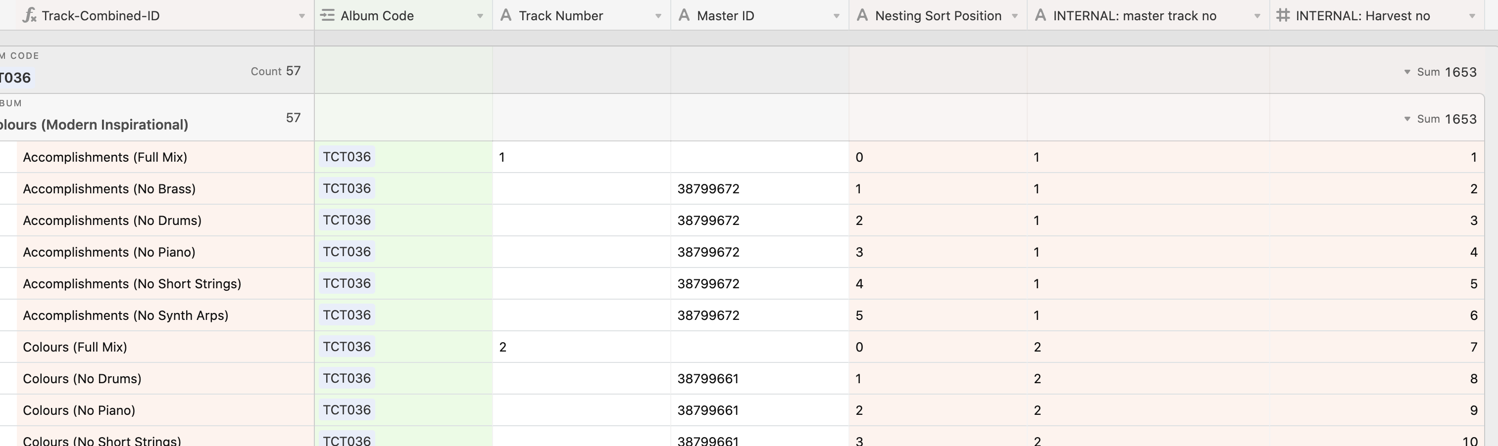

I’m also not entirely sure what you’d like the output to be. If you could provide a screenshot of data with the three fields you’re ranking by as well as INTERNAL: Harvest no that’d be really helpful
  • August 6, 2022
Hi Tonal, could I confirm that’s the full script? I’m asking because I don’t see where you’re declaring what fieldToRank1, fieldToRank2 and fieldToRank3 are
No, of course not. This is only the snippet of code that has gone wrong. Everything else in the code works fine.
fieldToRank1: album code
fieldToRank2: INTERNAL: master track no
fieldToRank3: Nesting Sort Position
Below is a screenshot showing these fields and the correct “INTERNAL: Harvest no”

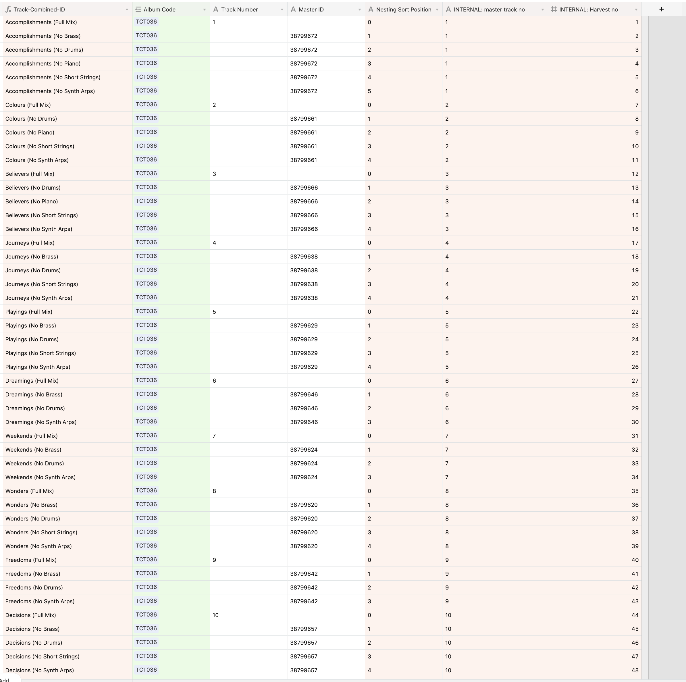

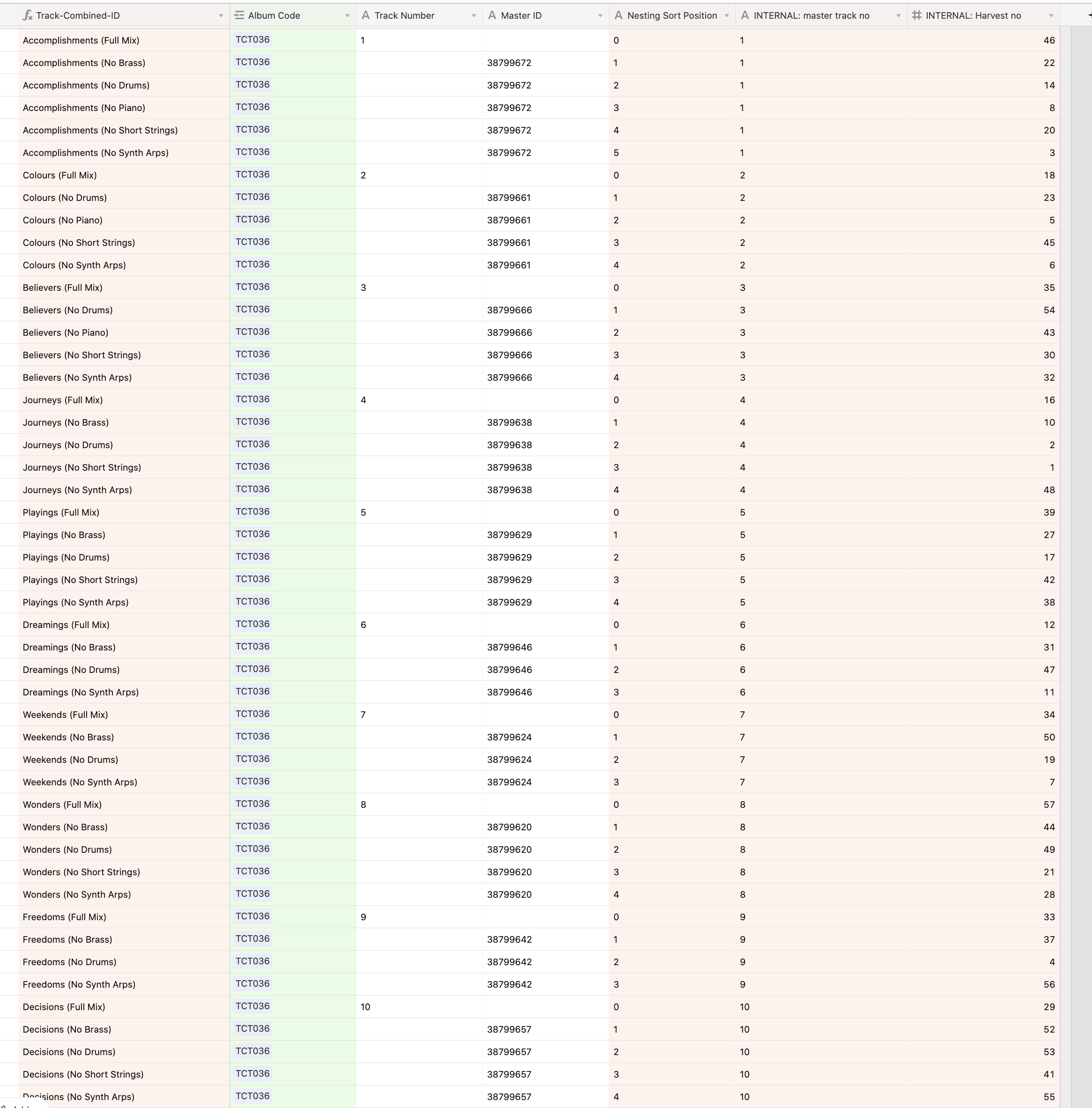

Negative, both fields 2 and 3 are text fields, as denoted by the “A” next to the column name.
Field 1 is the linked record “Album Code”. This shouldn’t matter in this case as they all have the same album code.
The screenshots are sorted in the same way as in my code, no grouping.
Below are the correct sort and the incorrect sort:
Correct (when I run the same code in a script that isn’t in Automations)
Incorrect (when I run the code in the Automation script)

I should add that the incorrect sort always seems to end up in the exact same order. So I suspect there is something happening where the data type returned in the fields from .selectRecordsAsync is different when I’m passing the IDs from the album through automation vs when I’m manually running the script and choose the album at the prompt. Maybe one is returning the field ID vs the actual value or something like that.
