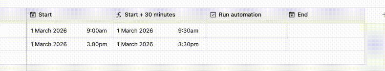

+1 for what ​@DisraeliGears01’s said and I’ve created a base here with the automation set up in case that’s helpful!

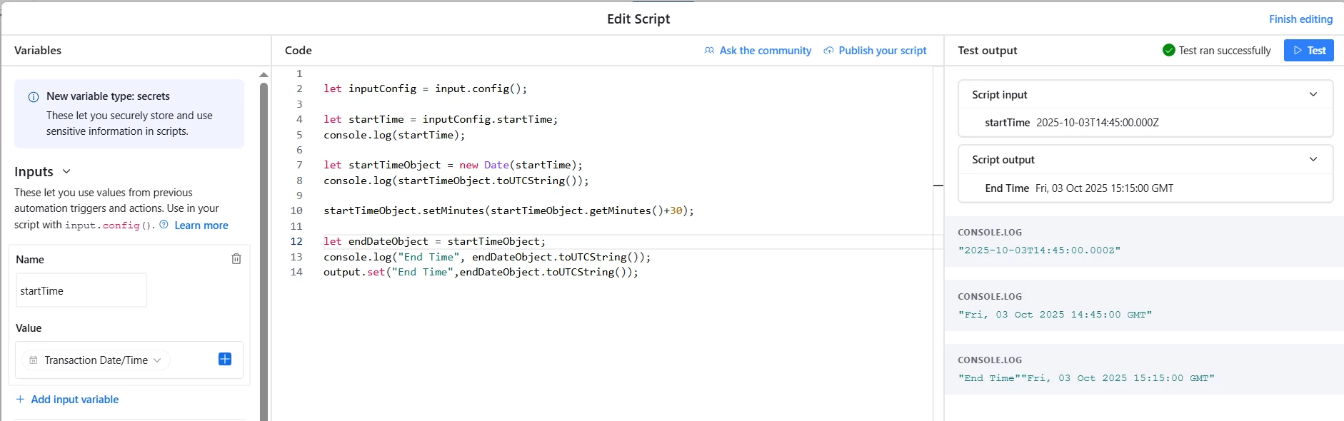

You can accomplish this with a simple 3 step automation. You’ll need to use a scripting block however. Here is how to do it:
  1. Set trigger to watch updates ‘Start Date’
  2. Add a conditional block to check if your booking type is 30 minute or the other one. If its 30 minute booking, proceed further
  3. Add a “Run script” step which will look something like the attached image:
    You will add the start time as input variable in the left side input tab and output the end time after calculation for it to be used in next steps
  4. Use the output of script step to update your record and set the end date
    Hope this helps.

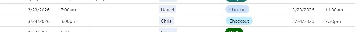

  • Mar 25, 2026 7:03 PM UTC
I created the formula field, however it is adding 4.5 hours instead of the 30 minutes I told it too. I was using 24hr format and thought maybe this was causing the problem as the output was in 12hr format. I changed it to 12hr format and the issue persists.
This is the formula used in the field (created via ai)
  OR({Service} = "Checkin", {Service} = "Checkout"),
    DATEADD({Start Date}, 30, 'minutes'),
    BLANK()
I tried using 1800 seconds instead of 30 minutes and result was exactly the same.

I bet this is a timezone conflict issue, Airtable loves to keep stuff in UTC/GMT. In your date field settings, expose timezones and see if there’s a difference, if so then then mark “Use same time zone for all collaborators”.
  • Mar 25, 2026 7:33 PM UTC
That resolved the issue! Can’t believe that didn’t occur to me!
Thank you so much
