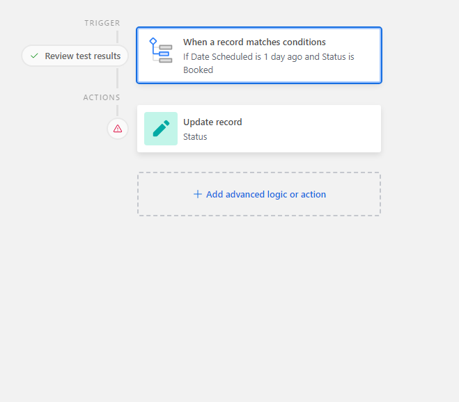

Hi, I am trying to create either a script or automation that will detect multiple records for me.
I have my trigger set up, If a record has a scheduled date that was one day ago and the status on it is "booked"
I want to then update anything under these conditions to "completed"
I am having issues setting up the "updating" feature.

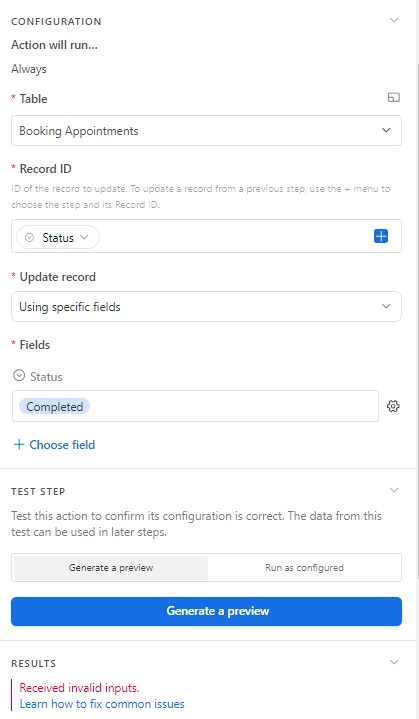

my configuration is as shown. I have NEVER done this type of automation, so I am extremely confused on this.
any help would be greatly appreciated!
Thanks in advance!
Ah, you need to be using an Airtable record ID for the "Record ID" input field:
Check out Airtable's guide on how to use the Update Record action: https://support.airtable.com/docs/update-record-action
