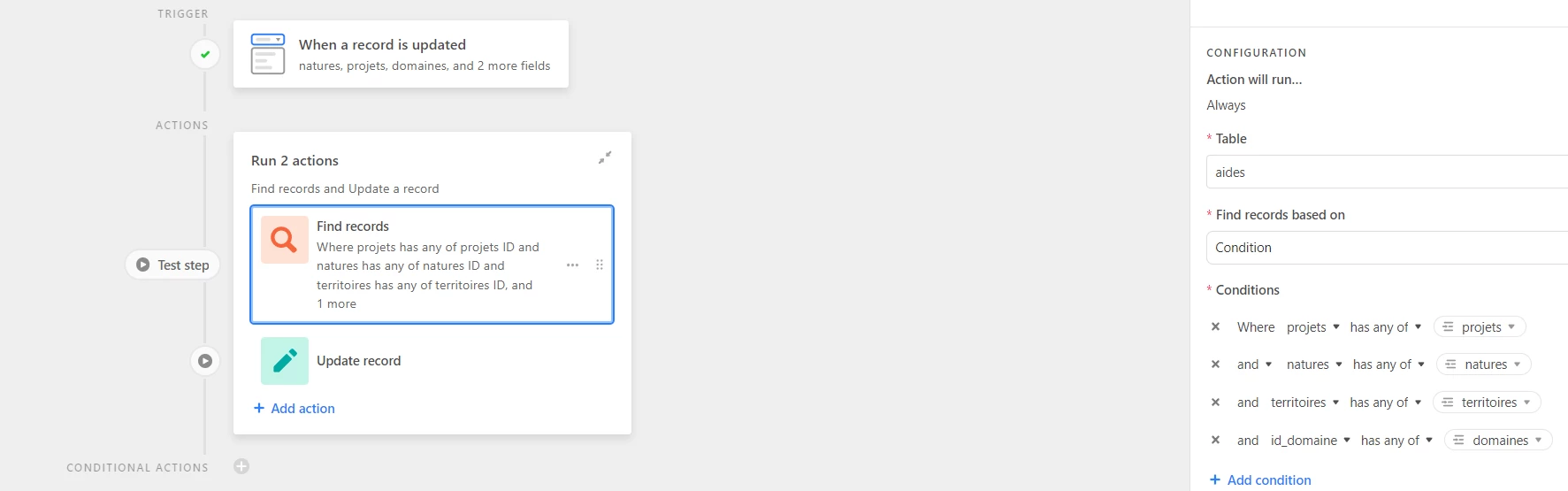

Hello,
I'm in need of a script to circumvent the 100 found records limit.
Here is my use case:
I have a database of 2k records updated on a weekly basis.
The user can setup and save complex filters (what I call alerts) to get a weekly email with new records.

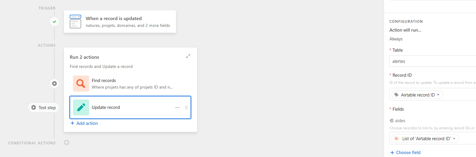

My automation searches in the [aides] table for records matching the criterias for the [alerte] record.
It then links the relevant [aides] records to the [alerte]
My issue is that it can only find 100, and I don't know how to do a script to replace the find records step.
Thank you very much for your help.

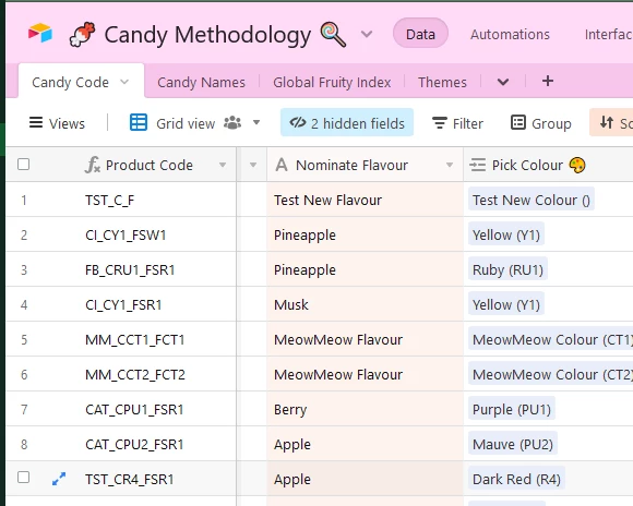

For example, this is my "Candy" base that I use for testing ideas (please don't ask me what "MeowMeow" colour is... 🐈 )
I need to "Find Records" on certain "Nominated flavours". To demonstrate how this can be done with JavaScript, I've taken the idea into the Scripting App and written the below;

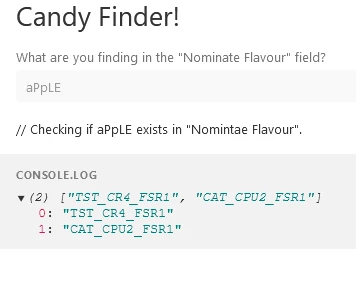

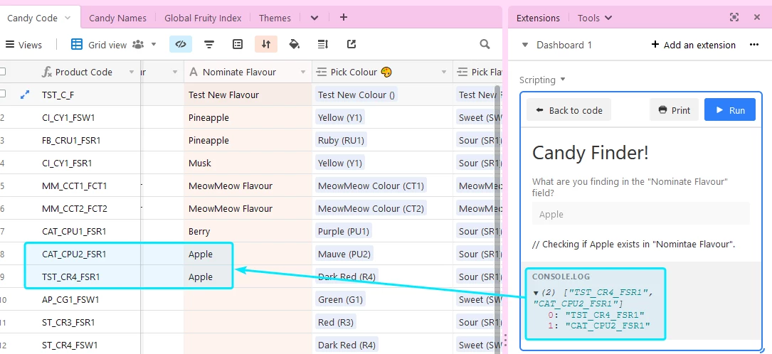

output.markdown('# Candy Finder!'); let userInput = await input.textAsync('What are you finding in the "Nominate Flavour" field?'); output.text(`// Checking if ${userInput} exists in "Nomintae Flavour".`); const candyTable = base.getTable("Candy Code") const allCandyRecords = await candyTable.selectRecordsAsync({ fields:["Product Code", "Nominate Flavour"] }); const foundResults = allCandyRecords.records .filter( record => record.getCellValueAsString("Nominate Flavour").toLowerCase() === userInput.toLowerCase()); console.log(foundResults.map( record => record.name))
 And this returns the user with an array of records that match the string;
Once you have an understanding of JavaScript methods such as .filter() and .map() (and there are others too that you should also learn, such as .reduce() and .forEach() ) and you get the general idea of this script working within the Scripting App Extension, it's usually fairly easy to get your Scripting App code then working within an Automation with minimal tweaking.
