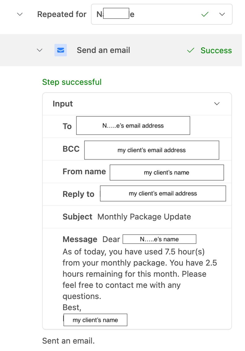

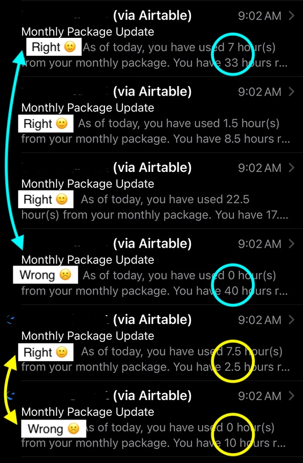

The Run History shows that earlier today, the automation ran once and 4 emails were sent. But my client got 6 emails! 2 were correct and only were sent once = yay; 2 were sent to the same email address twice - one with the right information and one with the wrong information = boo. So it's not happening every time to every email.
The attached multipleEmails picture tries to tell the story of what my client sent me using yellow and blue arrows. The emailExample picture shows a redacted view of the automation run history: each client has only one email and that one email shows the correct info for the client.

Best answer by pressGO_design
Thanks to @TheTimeSavingCo, I discovered that the automations from the previous year's base were still on and triggering and I'm now both super-excited to have (hopefully!) found the problem and also kicking myself for not double-checking that base 🙄🙄🙄🙄😤😤😤😤
Ooof.
