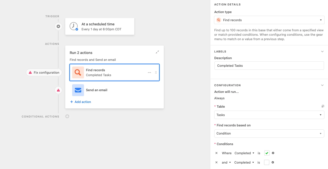

I’m trying to create a simple email automation that sends me a list of tasks that were completed each day, similar to the guide here.
How do I get the digest to only send tasks based on the Condition that the check box is completed AND it was completed since the last email (or today)?
In other words, how do I only select the newly completed tasks, not the full list each day?

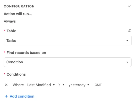

This is a great idea. Thank you.
I’ve modified the email automation to run overnight for all tasks that were completed yesterday.
One thing I noticed is that “yesterday” is set to GMT. I’m wondering if this will mess me up at all. Is there a way to change from GMT to my local time zone?
I’m not sure either honestly; the timezone stuff always throws me for a loop.
I would recommend you use a formula field to do the check so that you can easily verify stuff and use said formula field for your automation instead
