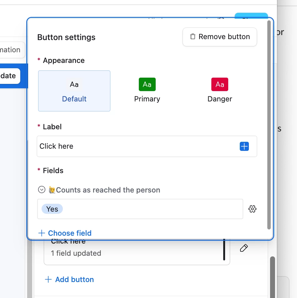

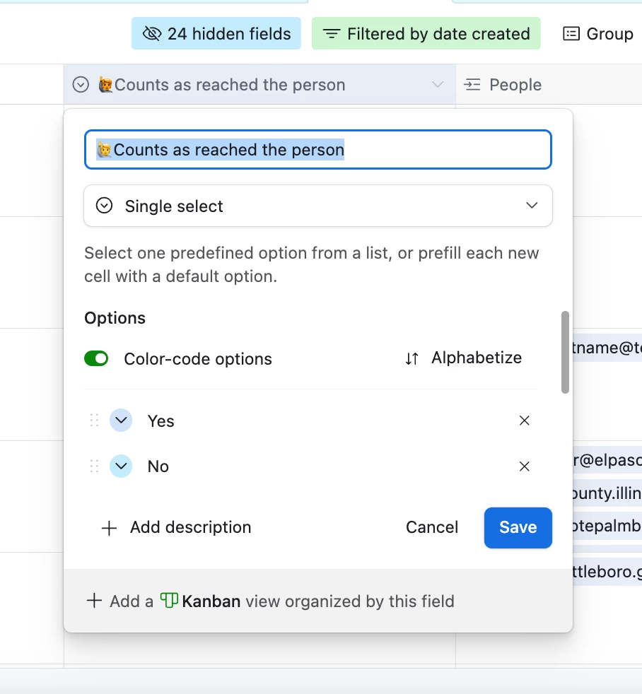

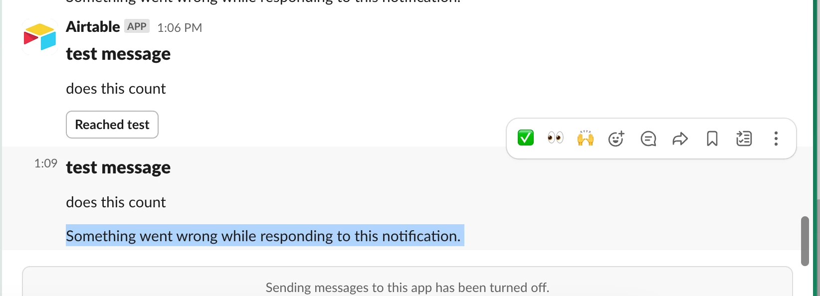

I’m running into an issue where the actionable message can’t action in Airtable. I’ve done a bunch of troubleshooting including the below, reconnecting my Slack account and looking into permissions for both Airtable and Slack. I successfully receive the actionable message in Slack and I can successfully click the button. But when I actually click it, I get a message “Something went wrong while responding to this notification.” Not sure what else to look for.
Hm, as a datapoint I just set up an actionable message, clicked it, and it made the update in Airtable as expected
Could you provide screenshots of the update action as well as a data view of the fields? e.g.

Sure! I also thought this error might be coming because the automation wasn’t live, I was only previewing it, but I activated it and got the same error.
Hmm, yeah, I hit this error the other day because of a field config, and was hoping that was happening to you too; looks like your setup is fine though
Does it work if you send it to a different user or put it into a channel?  Or even a whole new base / workspace / Slack?  (Just brainstorming at this point and I realize as I'm typing this that you’ve probably already tried these things, sorry!)
