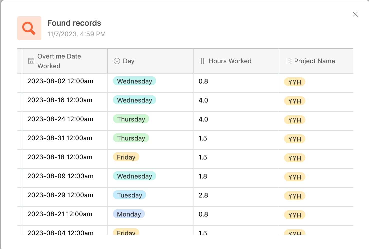

Hi all,
I'm using the 'Find Records' automation to get a grid of records to email to other people. Though my table is sorted by date, the records are being returned in a completely random order (see attached, specifically the Overtime Worked Date column). Any thoughts on how to make the grid return information that's ordered chronologically instead?
Thanks so much !!
Forum|alt.badge.img+24
  • November 7, 2023
Hi @user_533 ,
If "Find records based on" is set to "condition" then results are returned in random order.
Dynamic searches are not possible, but if "Find records based on" is set to "View" then results are returned in the sort order of the view.
