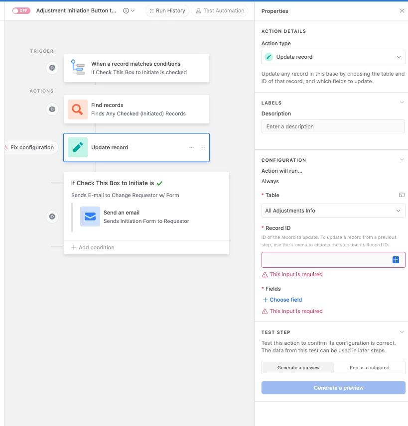

Hi All,
I tried to get feedback from ChatGPT but it steered me wrong. Lol.
Long story short, I'm trying to create an automation whereby, when a checkbox in a given record's checkbox field is checked:
  • A status field in the corresponding record is changed from "Upcoming" to "Initiated" (I assumed this was "Update Record").
  • Then, a pre-made form that I have created is automatically e-mailed to a recipient (whose e-mail is already rolled up/selected on another field) on the same record.
Where I'm stumped is -- on the update record action, it keeps asking for a mandatory unique record ID, and I'd like this change to instead apply to any record for which a user checks a checkbox in the checkbox field, not just a single, identified record.
Any thoughts? Am I doing this incorrectly?
ChatGPT said Airtable has some kind of mapping feature that could help me, here, but I couldn't find it.

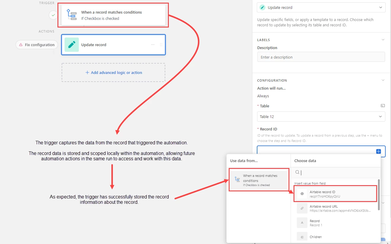

Hey @Tahir_Jetter!
The Update record automation action needs to know which record to update in order to successfully complete the update operation.
In order to update the record that triggered the automation run, you need to insert the record id of the relevant record.
To do this, you will insert the variable token from the automation trigger.
Here's a quick reference for you:

Is the system iterating through other records with the check box checked or is it just focused on the record for which the record ID is identified?
The automation run will be scoped to only the single record that triggered the run.
Automation runs are asynchronous. If you were to bulk update 100 records to trigger the automation, you wouldn't see a single automation run. You would see 100 unique automation runs that are scoped only to their respective records.
