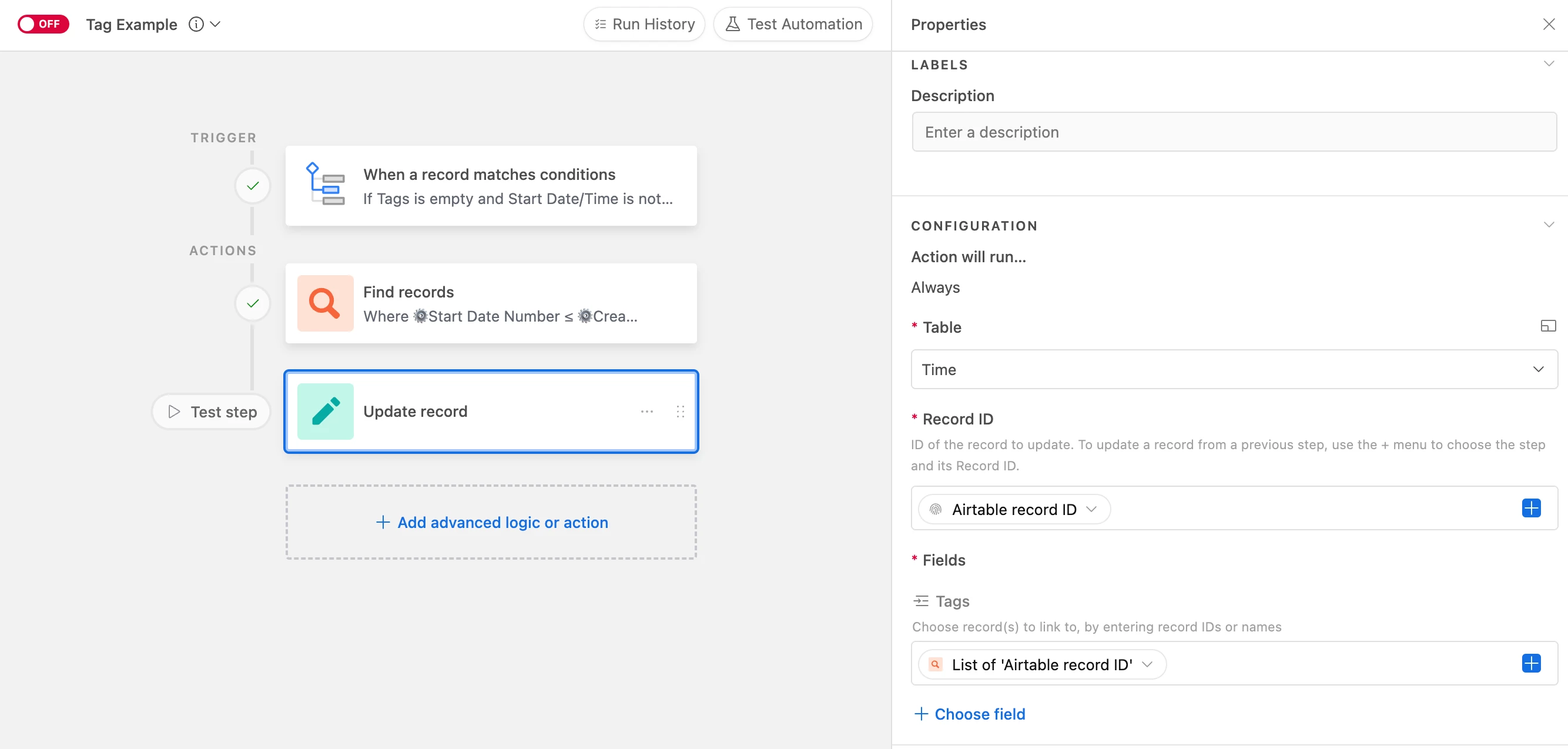

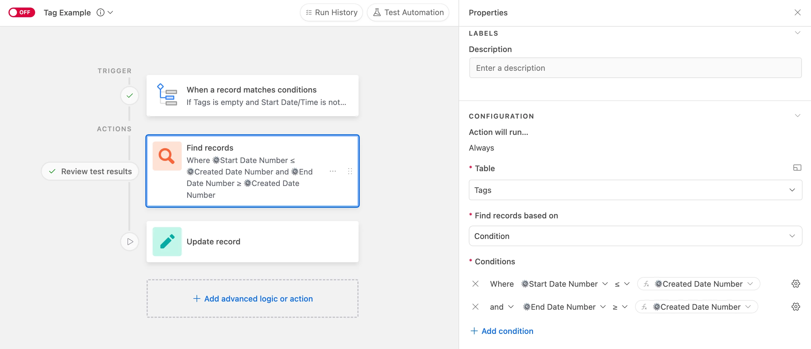

Do I understand correctly that I'll have to create a new automation for each tag? I can do this conditionally, but will need 12 automations for 12 tags?
  • April 2, 2024
No, you should only need one automation. When I get to my computer I can send a screenshot of what the setup should look like. Or in the interim if you can send a screenshot of what you have so far I can point you in the right direction 🙌
  • April 2, 2024
Here's an example of what your automation should look like 🙂
