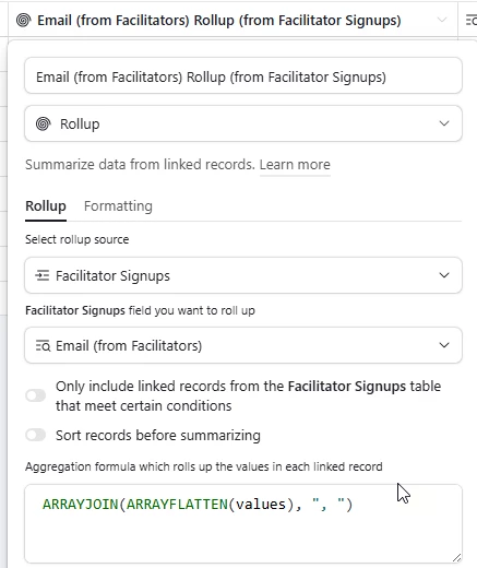

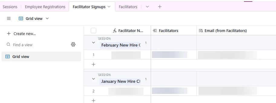

I apparently “Fixed” this in another project but here is the same problem in another. P.S. I just edited to say that I was able to get this to work only by configuring the automation through the “Signups” table vs. the “Sessions” table (in other words, not rolling up a lookup or rolling up a rollup, which seems impossible but I’d love to hear if I’m doing it wrong).
Facilitators sign up for a session. This is captured in the “Signups” table, linked to the Facilitator’s name and email in the “Facilitators” table (so the e-mail is a lookup field here).

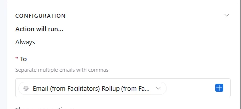

I am creating an automation in the “Sessions” table that I need to have sent to the e-mail of the Facilitator who signed up for the session. So I created a Rollup field in the “Sessions” table, rolling up the “Email” lookup field from the Signups table.
This Rollup field is what I have selected in the “To:” field of the email automation:
