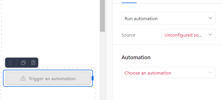

Thanks @TheTimeSavingCo! I had no clue that with a blank interface one could mix-and-match together different UI-elements. Why on earth isn't that possible to do with a list interface..?
But, when I added a button to the blank interface with a list of the projects and selected "Run automation", I can't select the automation to trigger. That "Choose an automation" is marked red and the dropdown can't be opened.
Would you know what I should do differently?
Rgds,
Björn
Rgds,
Björn
Try adding a Record Picker element to the page and setting that as the "Source"; you can pick any table for it as we're not using it at all.  You should then be able to select an automation via the dropdown list

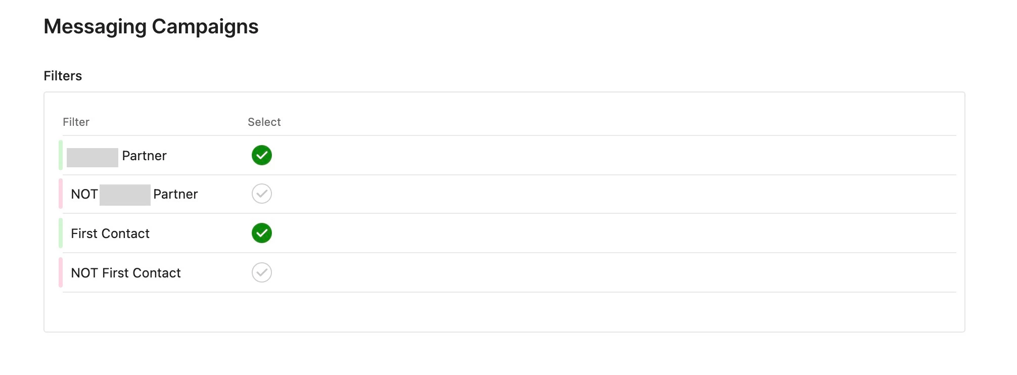

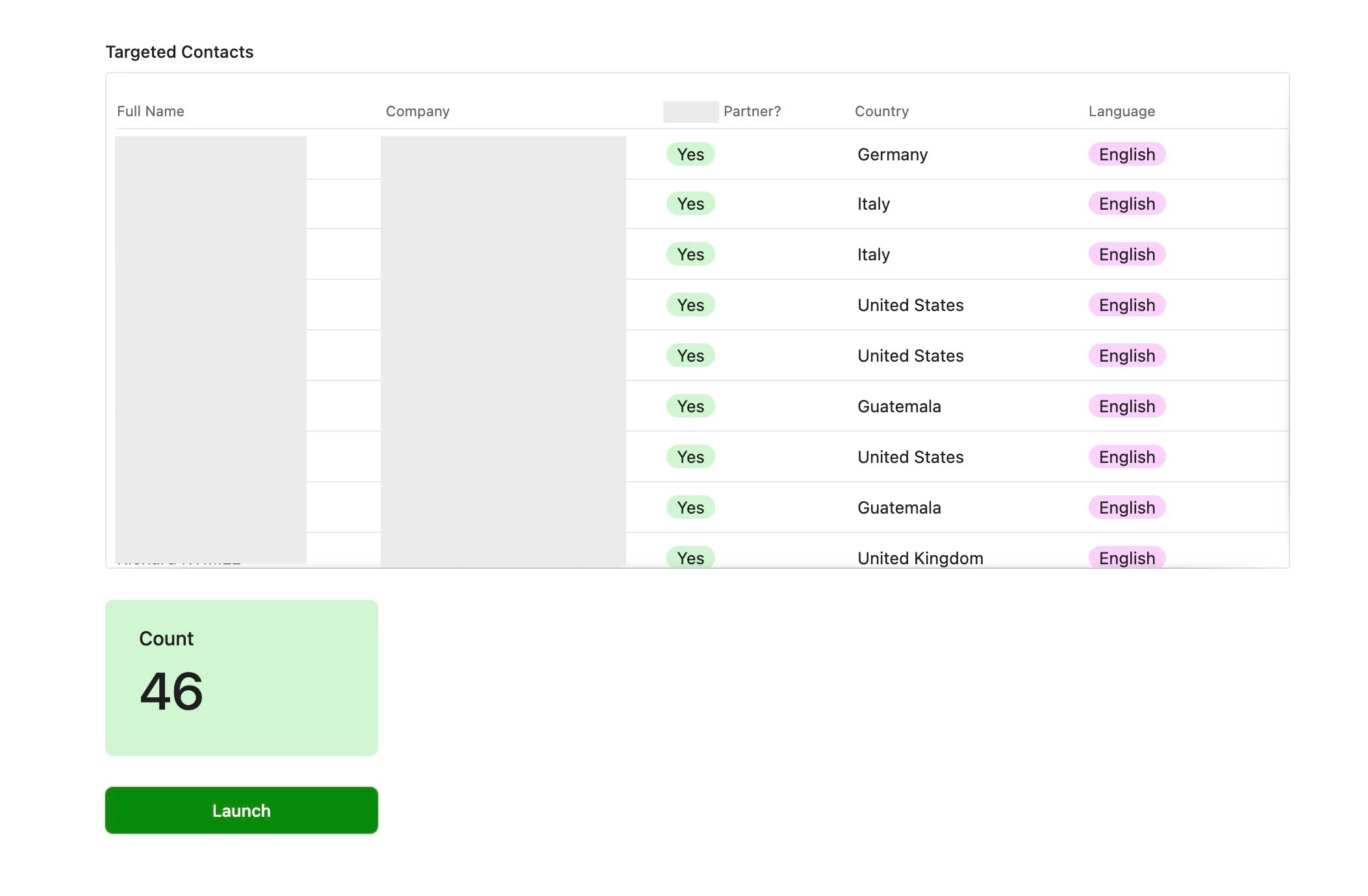

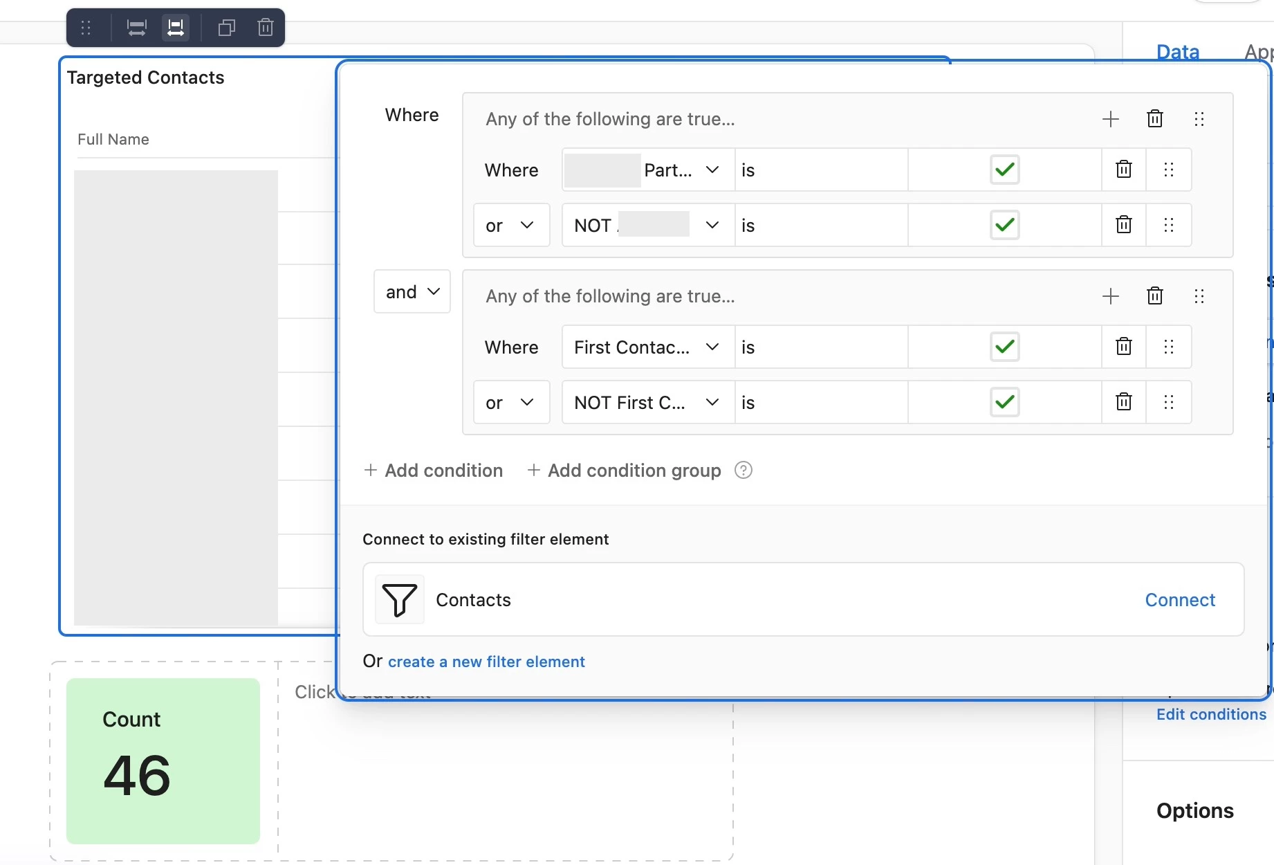

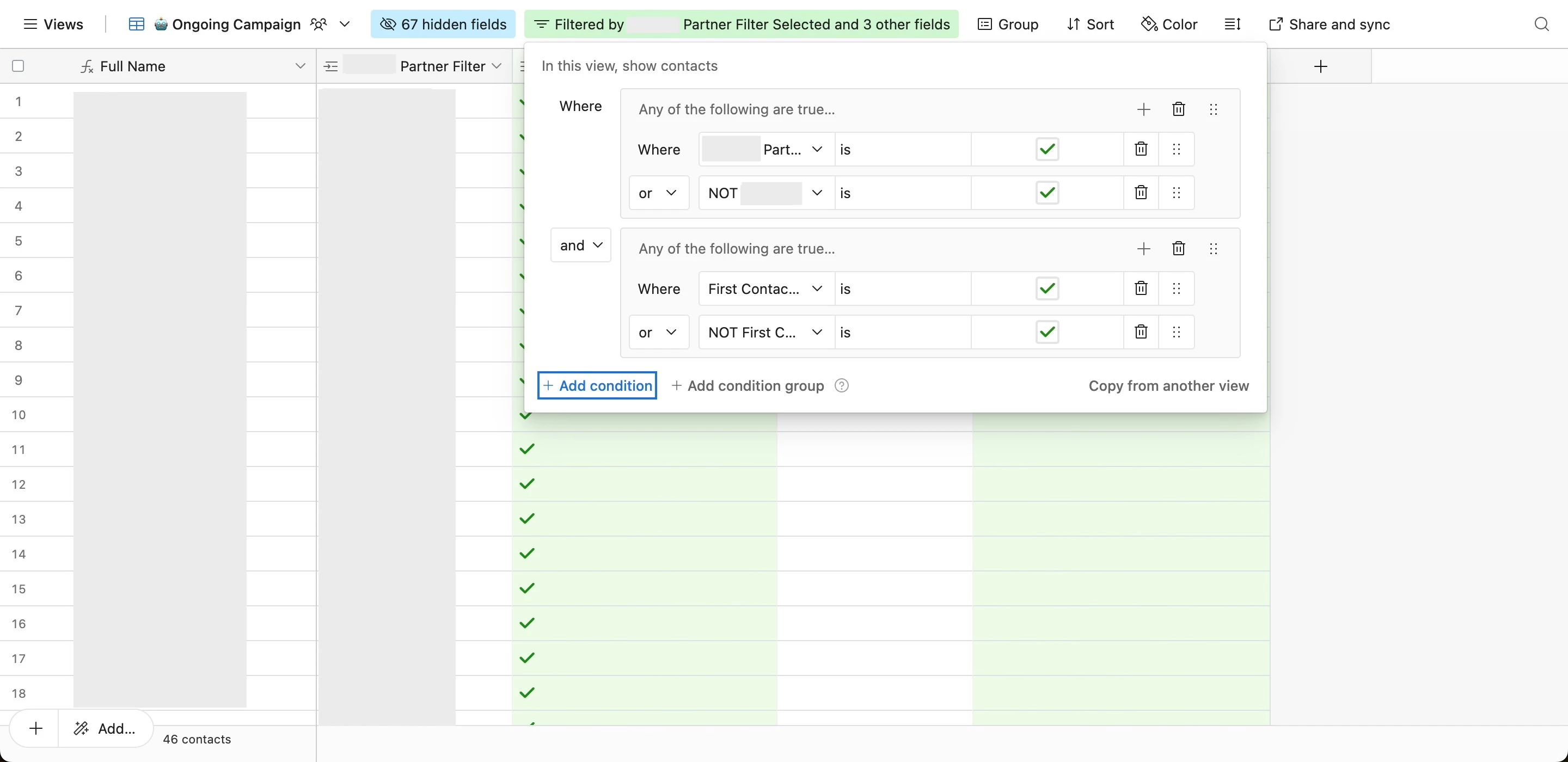

@TheTimeSavingCo I had a similar problem as @0800-grizzly: I wanted to run an automation based on filters I dynamically determine on an interface page. My use case: launch a LinkedIn messaging campaign to a specific list of contacts.
Thank you for suggesting a solution, it helped me a great deal. Getting inspiration from it, here's what I built (see screenshots). It may be helpful to others in the future who run into the same obstacle.
That being said, I find my solution to be clunky.
1. I created a linked-record field for each filter on my 'Contacts' table, which means that I have several many-to-one fields on that table that are linked to my 'LinkedIn Campaigns' table. I would much prefer to have a single connection linking the two tables.
2. I even had to create a field, not just for each filter, but for each filter's value. That means that if I were to make inadvertently a mistake, I could actually select the two boolean values of the same filter. e.g. 'First Contact' and 'NOT First Contact'.
3. Because of the filters I set up on the List and Count Number (see screenshots), contacts will be displayed only after I ticked one of the two values for each filter.
Do you or @kuovonne or any other one have a more elegant solution to suggest (even outside Airtable if the tool doesn't allow for one at the moment)?
