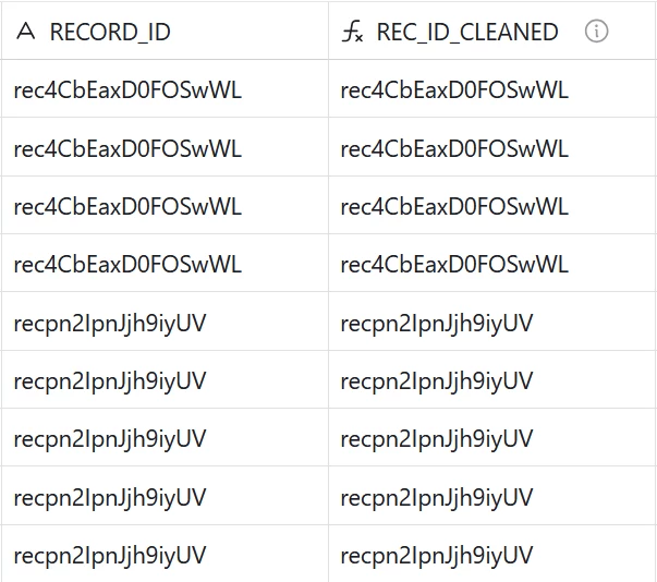

Clean the record_id with formula :
REGEX_EXTRACT({RECORD_ID}, "rec[a-zA-Z0-9]{14}")
PROBLEM FOUND
While I don’t understand where these white special characters may come from, I found that the text from the form is not clean (while it is invisible to eye)…
I don’t really understand where this might come from as I prefill the field with record_id only and hide it so it’s untouchable :
https://airtable.com/appNAdRxx7AIxxXXX/pagXXXPM3BbOCrTsN/form?prefill_RECORD_ID={Record_ID}&Type=Devis+sign%C3%A9&hide_RECORD_ID=true&hide_Type=true

Hello back,
I found why !!!
SOLUTION
PROBLEM FOUND
If someone find the answer, I welcome it ! :)
