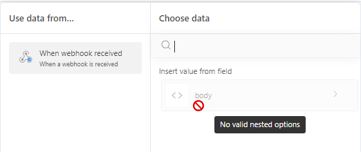

Hi! This is exactly the type of thing that I'm trying to do as well, but I'm getting a "No valid nested options" error.
I'm not sure if it's because the webhook from the source isn't formatted correctly, or if I'm doing something wrong in Airtable. The source of the webhook is from a knowledge base, and every article has an ID, which I track in Airtable as the unique ID. I'm trying to use the Find records step to find the article that matches, based on that unique ID, then update based on the values from the payload. I don't know how to use scripting, so I'm hoping there's a way to get around having to do that.
Thank you!!!
