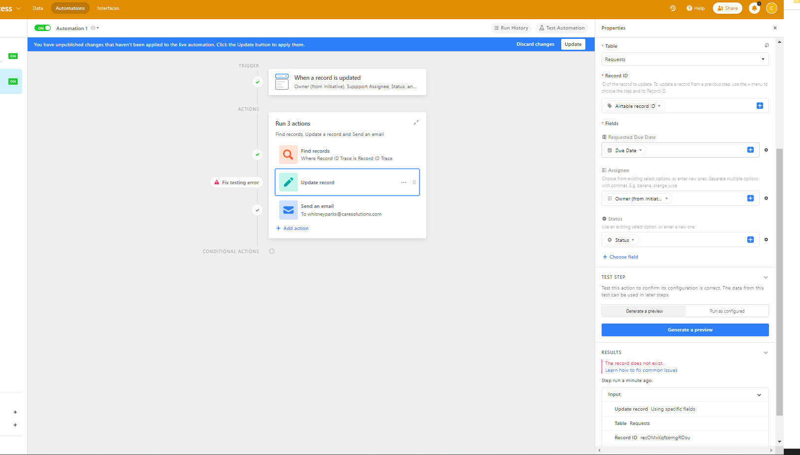

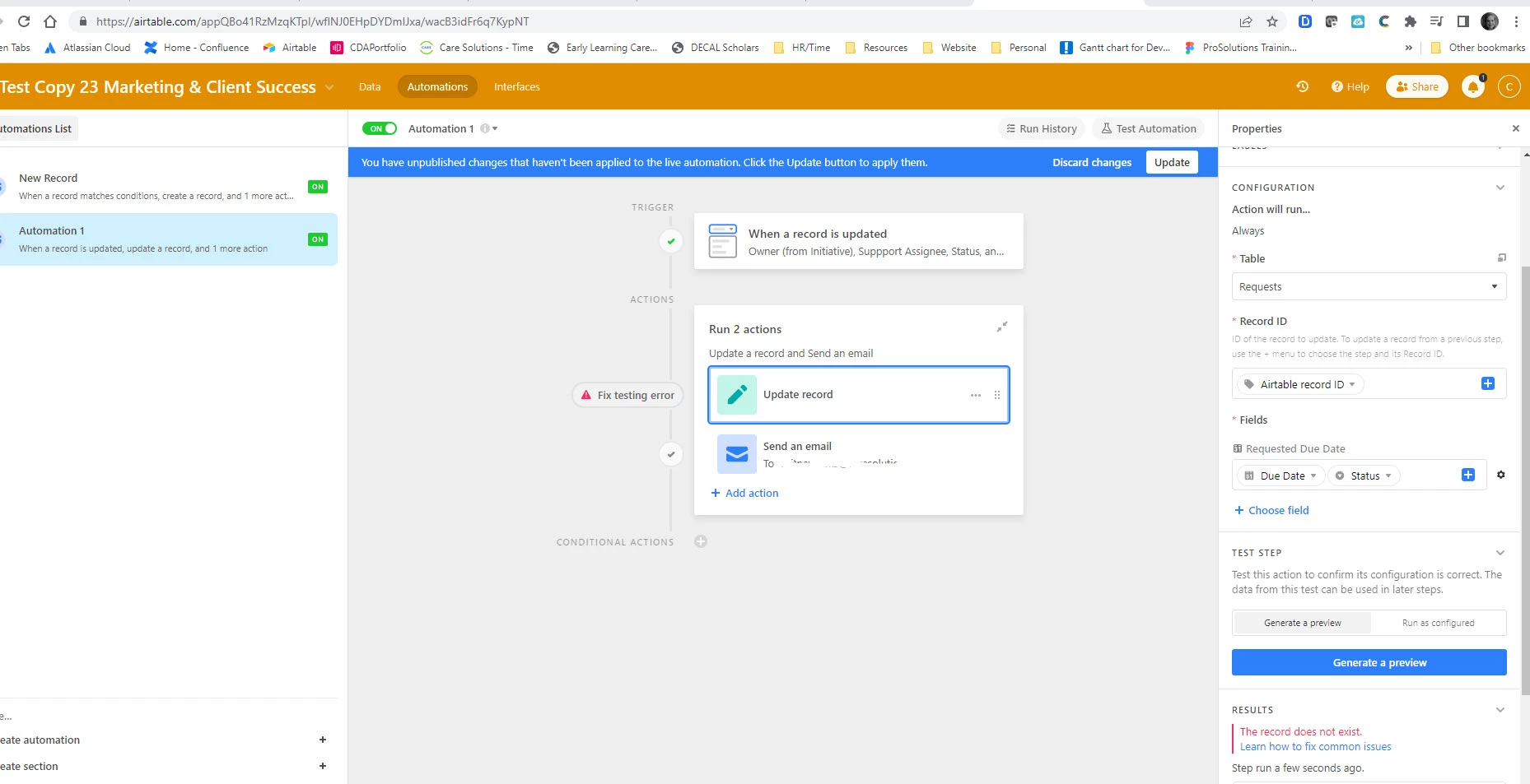

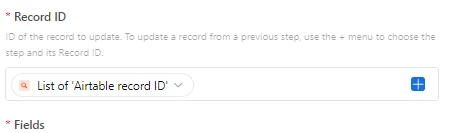

I am still getting stuck - user error, likely.   I was able to create the Record ID Trace field in all the right place and find the right record.
Now that I am in the Update Record section, I am getting an error.  I have a hunch I am missing a step or two.
When I initially find the record - I am searching for the one in the Strategic planning table, correct?  When I tried to search in the Requests table I didn't get any results.
Also, When I am updating the record in the requests table - what am I supposed to use for Record ID?  The Airtable record ID?  I keep getting "the record does not exist." (see screen shot)
Thank you so much for your help!!!  😄

  • March 2, 2024
This is very helpful!  Thank you!!

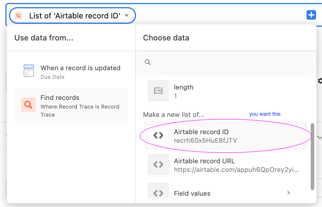

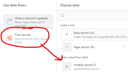

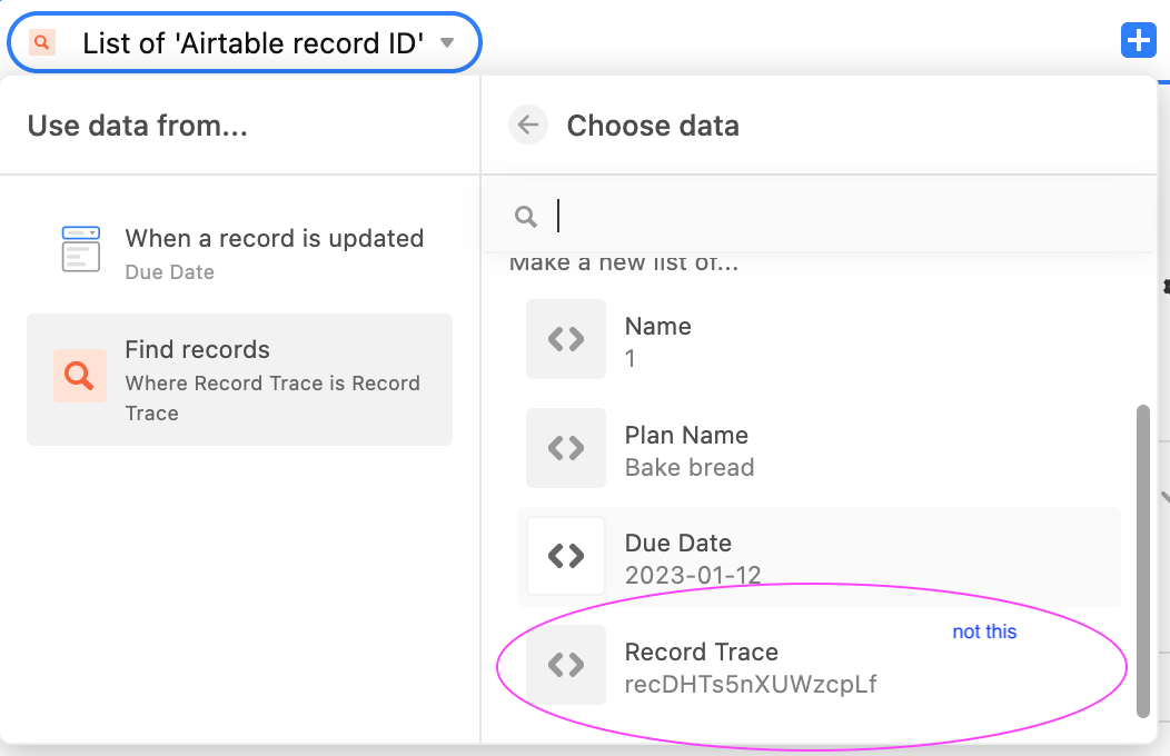

I ran into the same issue you just mentioned. Figured out you need to make sure you select the "Find Records" pane under the "Use data from..." popup and then select airtable record ID. It should look like this.
