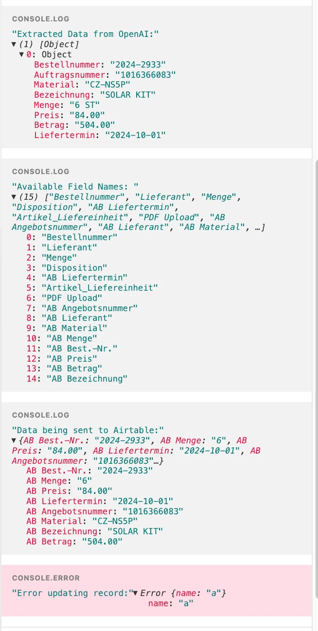

i want to read pdfs via the open api and fill the data into predefined tables.
Im not so experienced with JS, but with chatGPt I managed to receive already the correct data.
Now I get an error that doesn't help me any further. I checked all fields have correct names. The pdf data get correctly extracted.  Now im running in circles, I think the scripts tires to update Column 0 ("Bestellnummer") but shouldn't, I only want to update the fields with "AB".
If anyone can help here I would be very happy.
peace
this is the code:

// Log the extracted data from OpenAI
console.log("Extracted Data from OpenAI:", jsonData);
// Check Airtable field names to map them correctly
let table = base.getTable('Bestellung aus Disposition');
let fieldNames = table.fields.map(field => field.name);
console.log("Available Field Names: ", fieldNames);
// Ensure we're accessing the first object in the array
let extractedObject = jsonData[0];
// Extract the numeric part of "Menge" but treat it as text since all fields are single-line text fields
let mengeValue = extractedObject["Menge"] ? extractedObject["Menge"].split(" ")[0] : null; // Just the number part as a string
// Log the data being sent to Airtable to verify we're sending the correct fields
console.log("Data being sent to Airtable:", {
"AB Best.-Nr.": extractedObject["Bestellnummer"],
"AB Menge": mengeValue,
"AB Preis": extractedObject["Preis"],
"AB Liefertermin": extractedObject["Liefertermin"],
"AB Angebotsnummer": extractedObject["Auftragsnummer"],
"AB Material": extractedObject["Material"],
"AB Bezeichnung": extractedObject["Bezeichnung"],
"AB Betrag": extractedObject["Betrag"]
try {
await table.updateRecordAsync(recordId, {
"AB Best.-Nr.": extractedObject["Bestellnummer"], // Send as string
"AB Menge": mengeValue, // Send as string
"AB Preis": extractedObject["Preis"], // Send as string
"AB Liefertermin": extractedObject["Liefertermin"], // Send as string
"AB Angebotsnummer": extractedObject["Auftragsnummer"], // Send as string
"AB Material": extractedObject["Material"], // Send as string
"AB Bezeichnung": extractedObject["Bezeichnung"], // Send as string
"AB Betrag": extractedObject["Betrag"] // Send as string
console.log("Record successfully updated.");
} catch (error) {
console.error("Error updating record:", error);
output.set("message", `Record for ${lieferant} (Record ID: ${recordId}) successfully updated with data from PDF file: ${pdfUrl}.`);

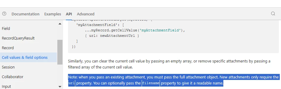

chatGPT often overengineering things that are more simple. also, it mixes methods from scripting extension with methods of automation and API, so the result code usually works nowhere. But in your case It feels like code is mostly OK.
To update attachment field, you should pass url:  property (and optionally filename:)
 Actually, it should be array of urls
[ {url:'http://....'} , {url:'http://....'} , {url:'http://....'} ]
even if it contains just 1 file, it must be array
