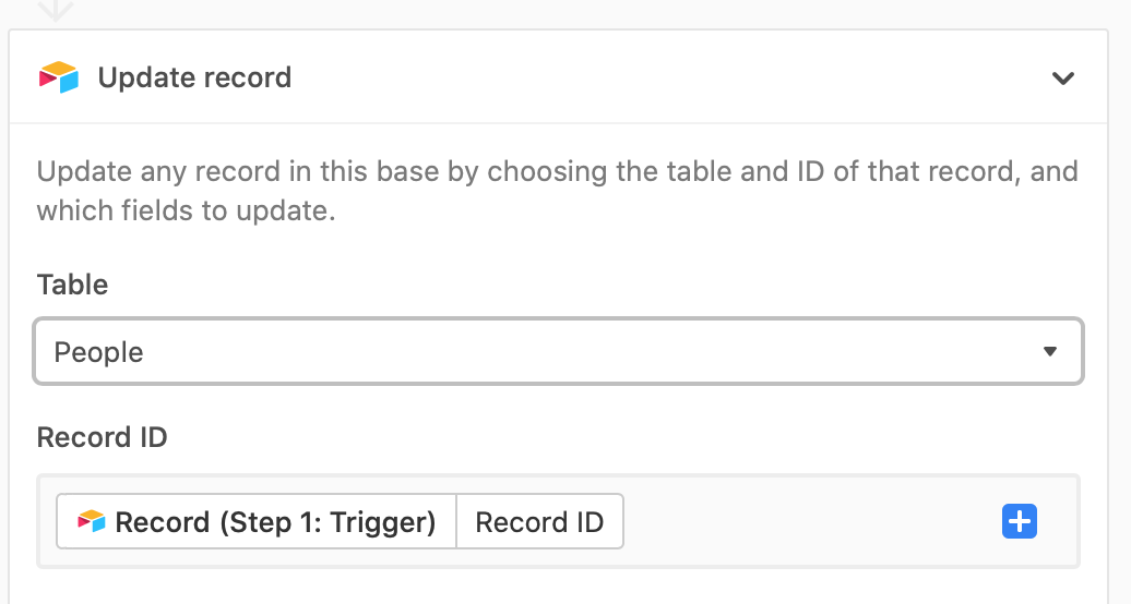

  • September 23, 2020
Welcome to the community, @Lia_Marley and @Brendan_York!
You don’t need to literally specify a Record ID (although you could, if you wanted to).
You just choose the step from which you want to pull the Record ID from, and then choose “Record ID” from that step. Airtable will then substitute the appropriate Record ID when the automation is run.
Check out the screenshot below.

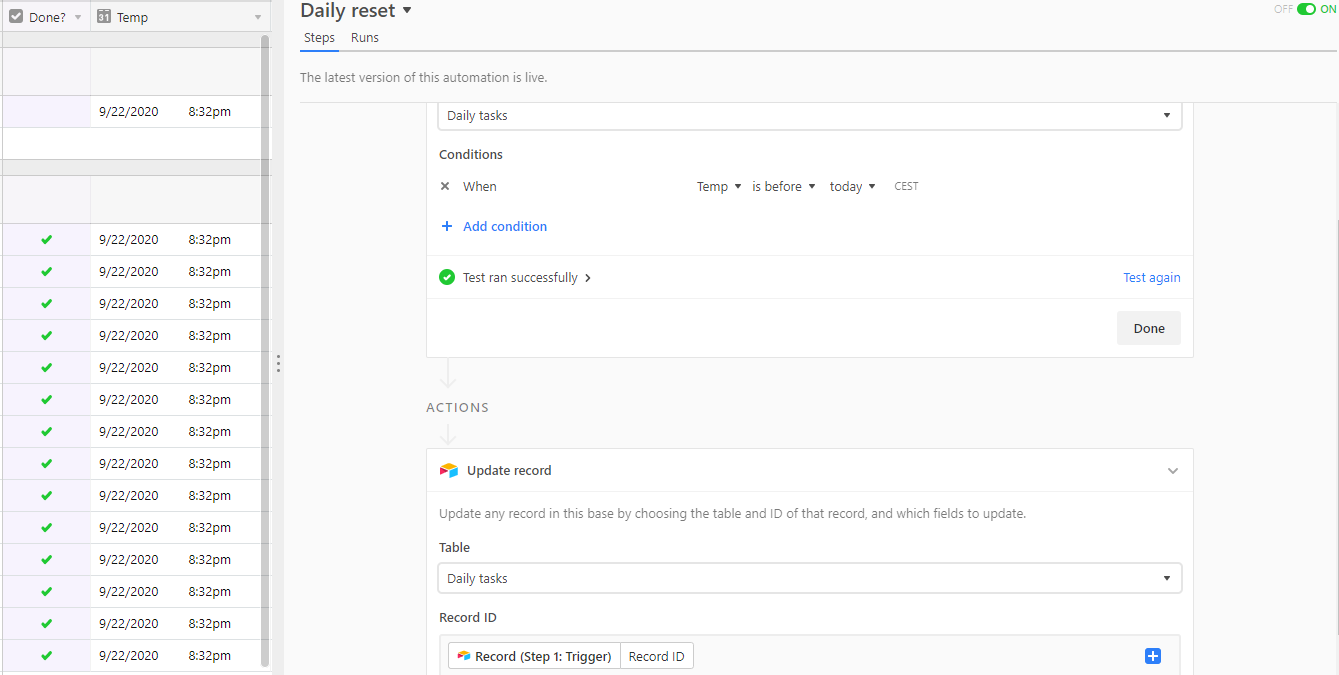

Thanks for the welcome and the quick reply, @ScottWorld!
I was able to get it to work for 1 record when I tried that and clicked “Test”, but then it stops even though I turn on the automation:
Since Temp is before today for every record, it seems like the automation should keep being triggered.
Any idea how to make it uncheck all records when any one record is past the due date/time?
Two things:
  1. Once you turn on the automation, it will only run on records that NEWLY match your trigger from that point forward. It won’t go back and trigger on older records that matched your criteria in the past. So, to re-trigger on those records, you could just clear out their date fields & then repopulate them again with the exact same information.
  2. If it’s still not triggering on those records, then it’s likely a time zone mismatch error. You’ll notice that in your automation, your time zone is set to CEST. But your “Temp” field might be set to GMT time zone, if you’ve enabled the option that says “Use the same time zone (GMT) for all collaborators”.
For more information on working with multiple time zones in Airtable, check out my sample time zones base & time zones training video here:

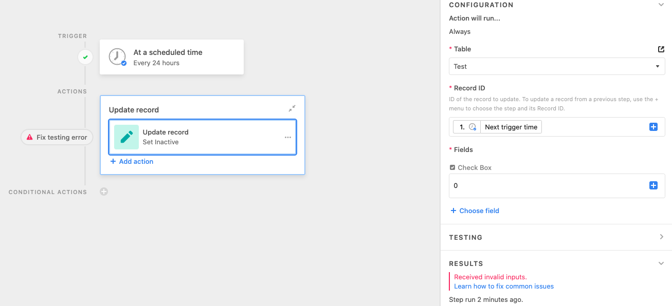

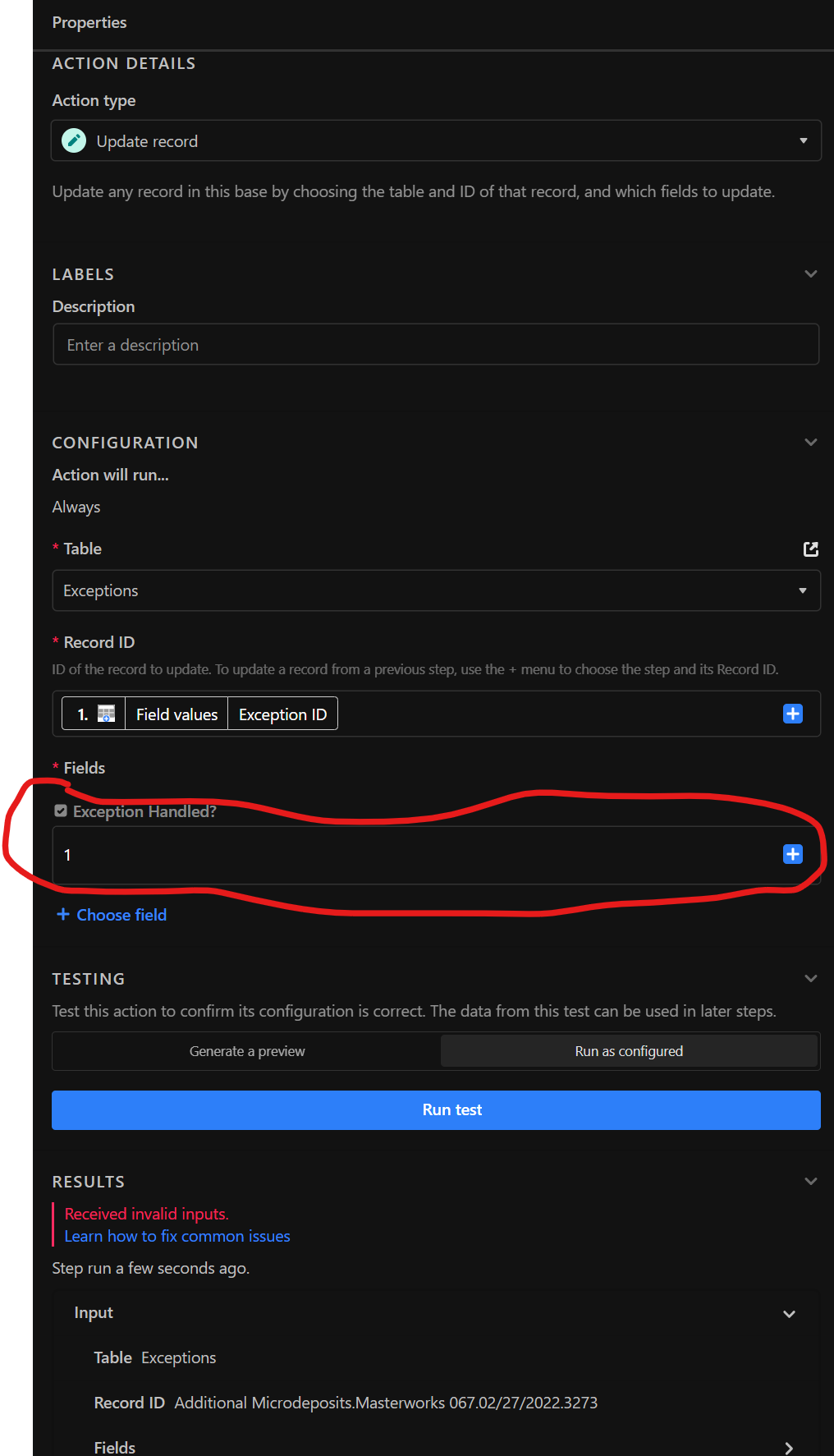

  • April 20, 2022
Yes, in the “Update Record” action step, choose your checkbox field and then type the number 1 in the blank box that appears. (1 is checked, 0 is unchecked.)
Hi Scott, I typed the number 1 in the black box but it encounter an error. Please see the attached screenshot if you could. Any advice?
Thanks a lot!
  • April 20, 2022
Thanks a lot!
Your Record ID is wrong, not the number 1. Watch the animated GIFs on this page to learn what to do:

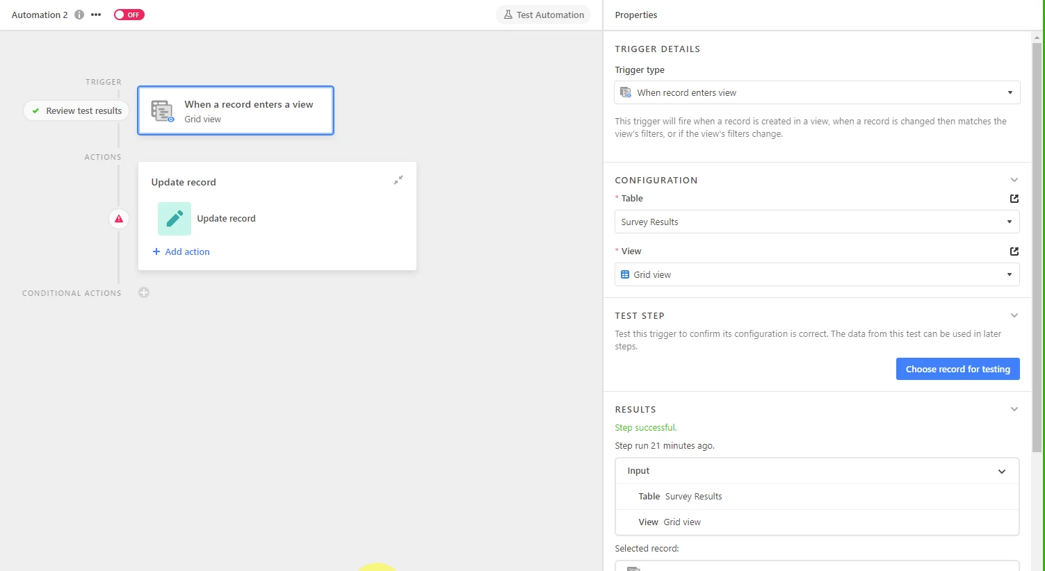

Forum|alt.badge.img+10
Hello all,
It’s possible that we may have strayed off topic a little…
I believe the topic is “Using Automations to Check a Box When Record Matches Conditions”.
And while “Update Record” IS a condition, it seems like a much more advanced answer then would be for, say “When a Record is Created”. And sadly it doesn’t look like the answers would be the same either. So one doesn’t necessarily help the other.
So, WITH SCREENSHOTS (please), can someone please explain how to use an automation to check a box? I’m putting one’s and zero’s everywhere and nothing is working!
Also, am I doing something different here? Why does my “Automation” area look so different than everyone else’s???
MINE:
ONE FROM THIS THREAD:
Thanks!
