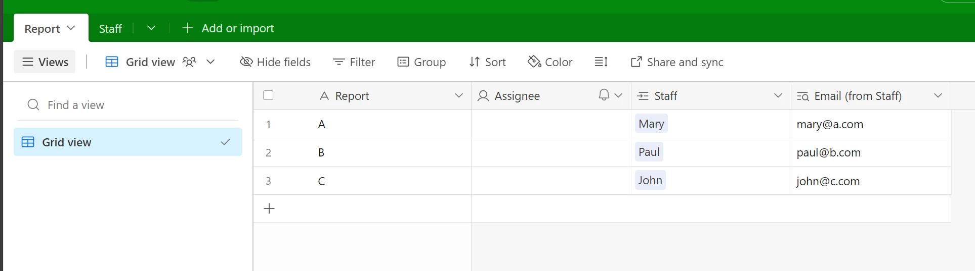

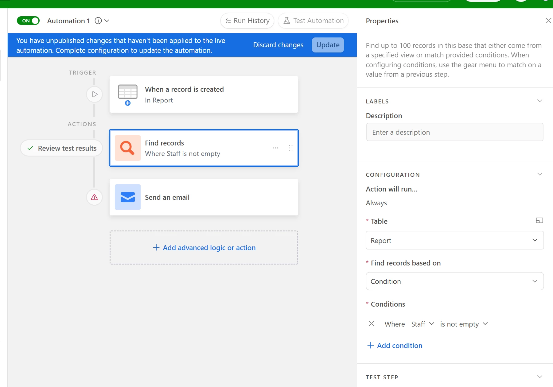

Hi, let me know if I understood correctly.
when you create a new record, the automation start but you didn't fill out the column "staff" with the information for the email.
If it is correct, you need something to delay the automation like this:
if it isn't enough, you can add something like a formula and set as condition "when it is not empty"
Let me know if I wrong everything ahah or if you have any questions 🙂
