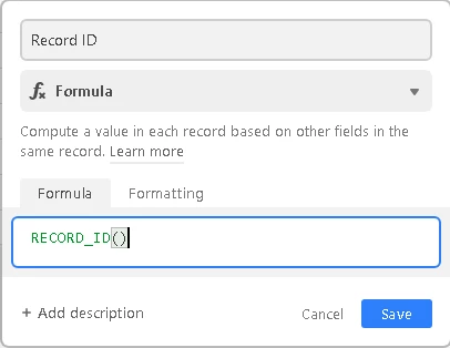

Add a formula field and input: Record_ID() to see the id for each record.

You can always just use a button field for this. Just attach the URL (with the Record ID appended) into an “Open URL” button field, and then click on the button to trigger your webhook.
Your formula would look something like this:
"https://example.com?RecordID=" & RECORD_ID()

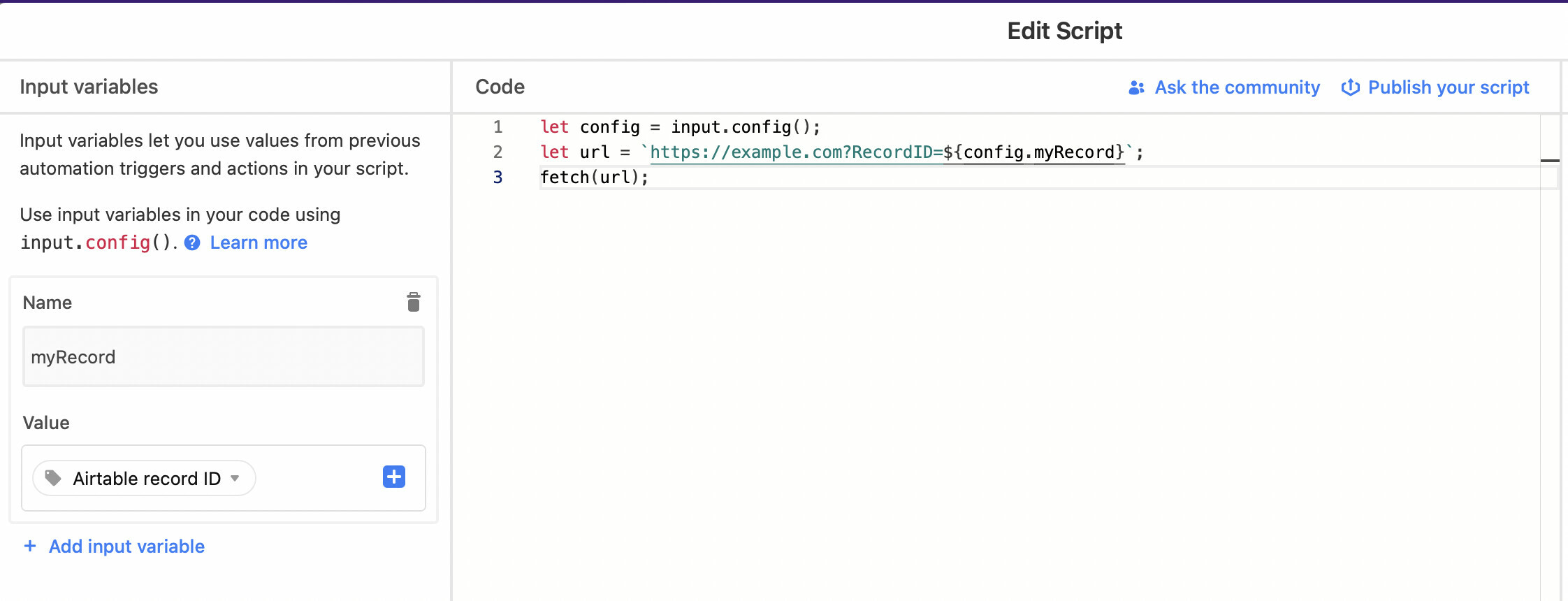

Alternatively, you can do this with a script in an automation… it would look something like the screenshot below:
And here is the code from that screenshot:
let config = input.config();
let url = `https://example.com?RecordID=${config.myRecord}`;
fetch(url);
