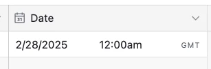

Hmm, as a datapoint, I just tried creating an Outlook event via the automation for 28 Feb and it worked as expected, here's the date field set to display as European

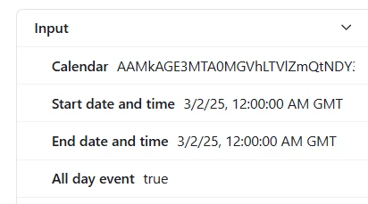

And the created event is in +8 as that's my timezone, and this is the automation result:
And here's the date listed in the email invite:
I also tried changing the display of the field to be US to see if that changed anything and that worked fine:
