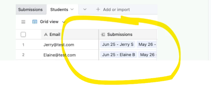

Here is the print:

​@Alexandra
How can I ensure that when a form response is entered, that information appears in the "submissions" field linked to the "Submission" table?
This will happen automatically when you put the email address in “Students” column (a linked record field linking to Students table). Since Email is your first column in Students table, any email entered in “Students” column of Submissions table will link it to exactly matching Students record and the corresponding “Submissions” column in Students table will also show that linkage.
Thanks for the screenshot!  This depends on how the data’s created in Airtable.  Assuming we’re importing them in bulk via a CSV then we’d put the CSV’s email value into the linked field when we’re importing via the CSV Import extension (https://support.airtable.com/docs/csv-import-extension)
If people are actually submitting the form, we probably have a text field for them to key in their email address (if we did a linked field we’d be exposing the emails of all the Students to anyone with access to the form), and so you’d have an automation that triggers when the form submits to paste the email value into the linked field
If you could talk more about how your data gets created in Airtable that’d be helpful!
