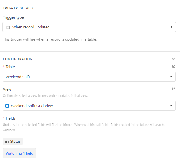

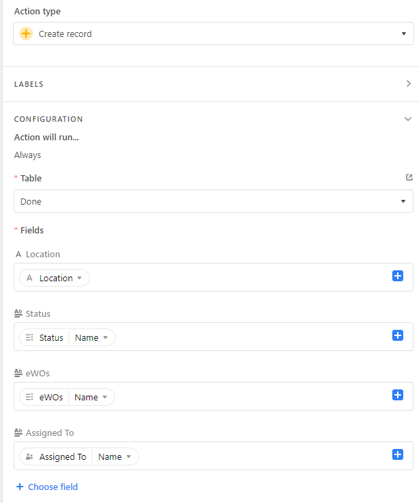

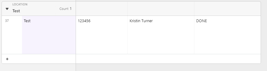

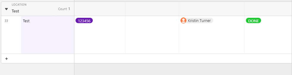

Here’s what I’ve got:
In Weekend Shift Tab when Status says Done
then remove record from Weekend Shift Tab and place in the Done Tab like this:
I’ve followed this tutorial: Airtable Automation - Move A Record To Another Table: No-Code Tutorial - YouTube

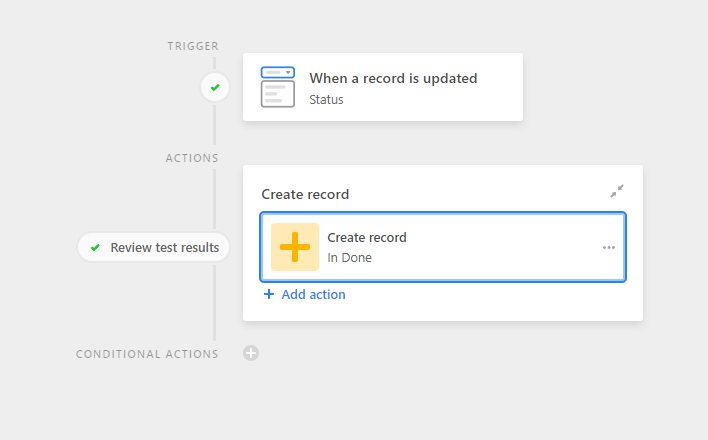

I’ve made the automation work to pull the data in but:
A) It doesn’t erase/hide the original data from the Weekend Shift tab.
B) It pulls in every status not just the ones marked DONE.
What am I doing wrong? Pictures for automation setup
Hi Kristin
Hmm, deleting records would require you to use a script, which might be more trouble than it’s worth here. How do you feel about changing the status of the original record in the Weekend Shift table to “Transferred” or some such?
This would allow you to filter them out of your views as needed
To do this, we’d just add another action step to update the original record’s Status value

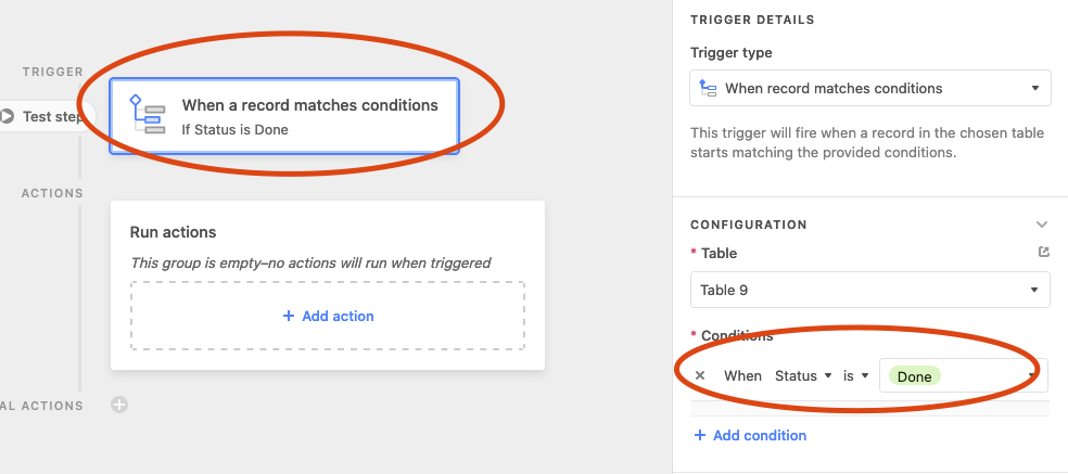

The automation’s currently set up to trigger whenever the Status field is updated. As we only want the automation to trigger when the Status field’s value is “Done”, we need to make the trigger the following instead:

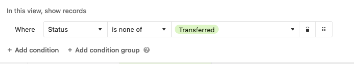

Ah, I was thinking we’d just have a filter that filtered out all records with the status “Transferred”, like so:
And so, technically, once the Status is “Transferred”, it’s automatically hidden from view.
