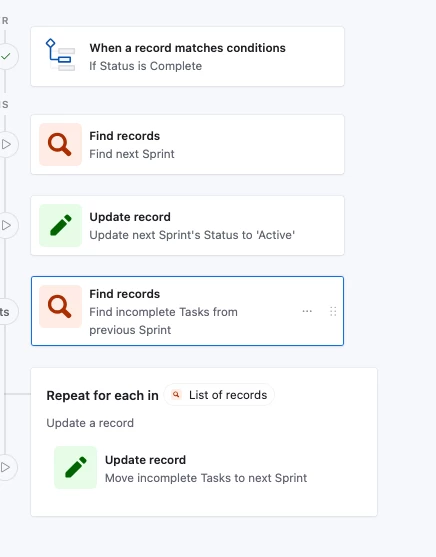

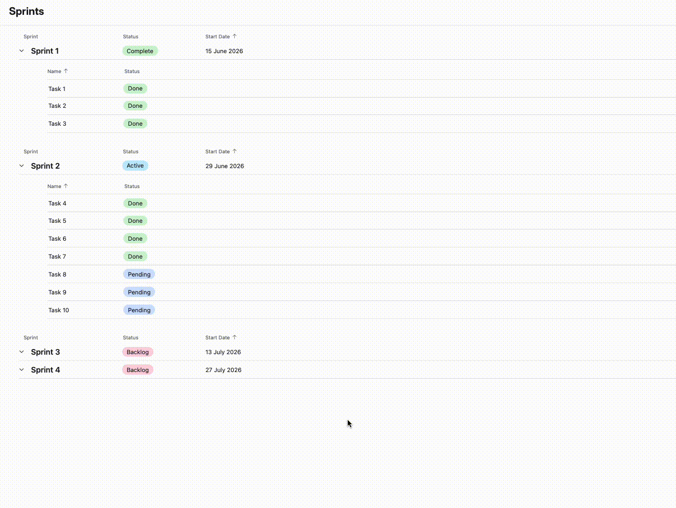

Here’s a base with the solution ​@DisraeliGears01 mentioned in the first reply, and you can duplicate it into your own workspace to play with it!

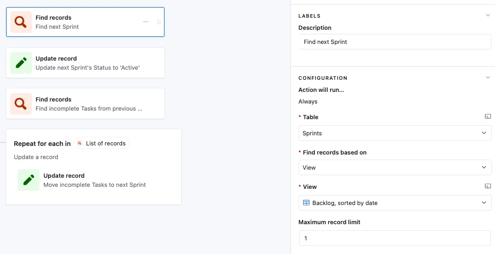

To find the next Sprint, I created a view that filters to only display ‘Backlog’ Sprints, sorted by the Sprint date, and the ‘Find next Sprint’ Find Records action looks at that view and only outputs 1 record:
(Instead of setting up the view, you could do this without a view and use a combination Sort List action + Script action to handle it too)
