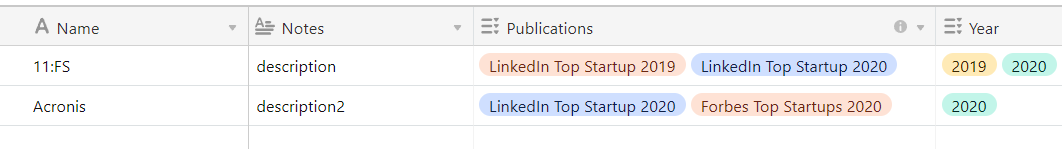

I am trying to set this up.
I have a Table with a list of companies, years, and list links where I got them from.
I have another table with the list links, list names and years.
I am trying to get the companies to merge into one source with the list names and years that they appeared. Images below - the one with colored multiple select is the similar to what I’m looking ot get as a result.
Any help if all of the companies are in one table appended for each list.

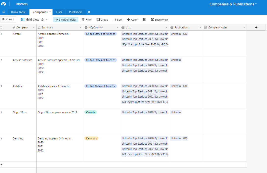

Companies
The first thing I did was create a dedicated companies table.
This table contains a single record for every company.
This allows me to consolidate and focus my data.
See, instead of having to link multiple publications/lists to multiple company records, all I have to do now is worry about linking multiple records to a single record.

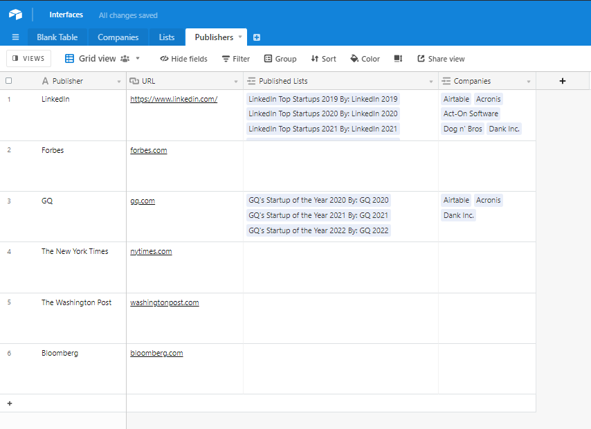

Publishers
This table holds records for each publication.
I wasn’t too sure what your data looks like, so I just added in some placeholder publications and outlets, etc.
I just have a sample URL to the website of the publication as an example for data we can store for these records.

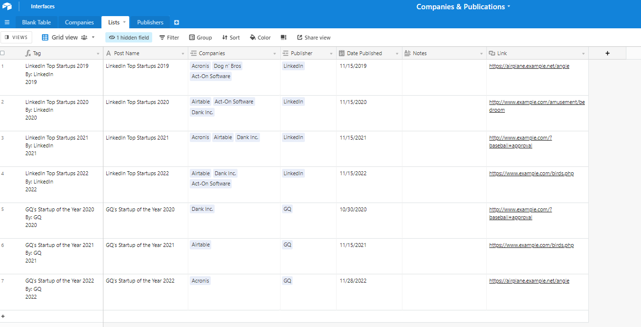

Lists
It seems like list is a synonym for any sort of published article and such. Thus, I’m just gonna talk about it that way.
The table holds records for every individual published article and list
We have linked records for the given publication, as well as any associated companies that are listed and associated with the article.
The record has a field for the title of the post, as well as details like the URL, as well as the date it was published.
The primary field is a formula field that builds a tag to summarize key information.
It lists the post name, the publisher, as well as the year that it was published.

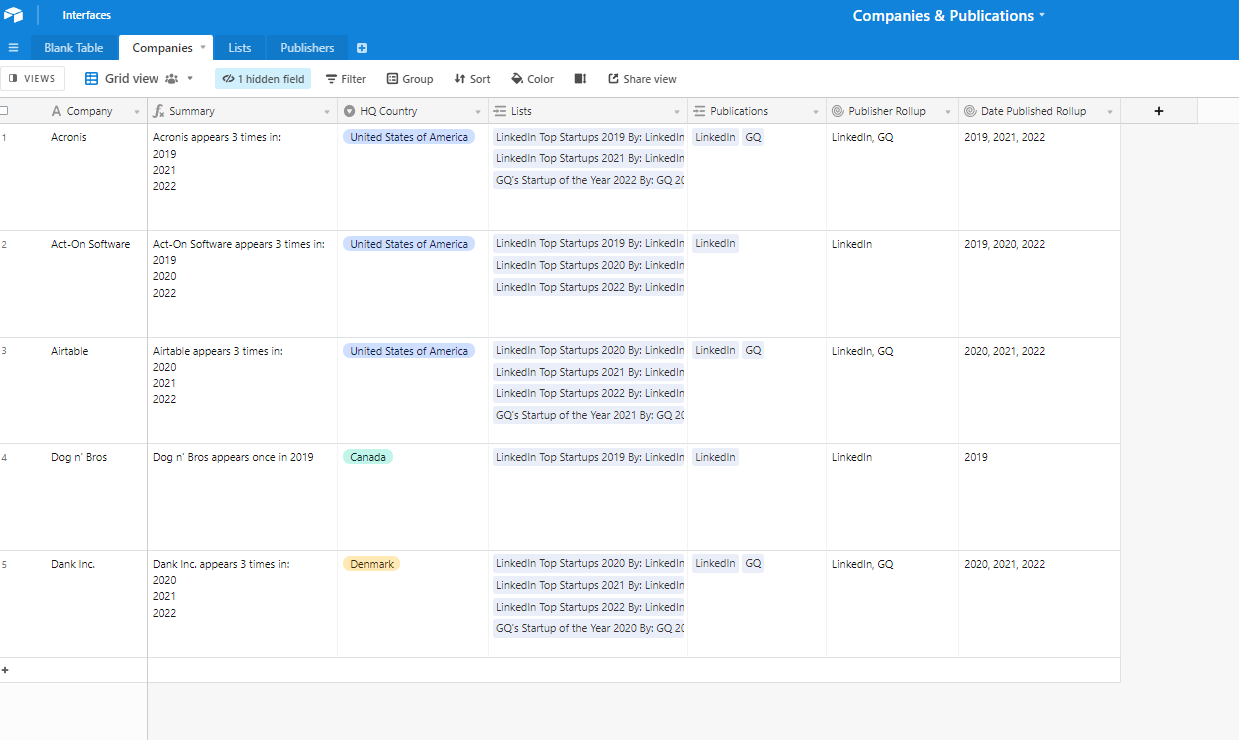

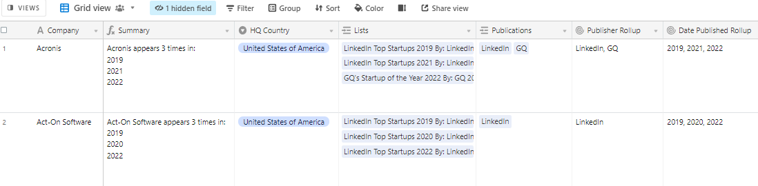

If you look at the first screenshot of the Companies table, you’ll notice that there are a few fields hidden.
These fields are rollup fields that provide summarized information about the publishers that have referenced a given company, as well as the years that any articles/lists were published.
The rollups use the ARRAYUNIQUE function to avoid duplicates.

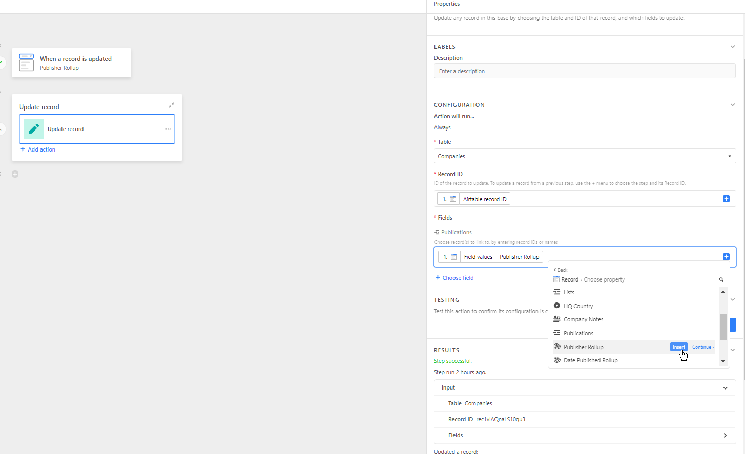

The thing I needed to do was to find a way to establish a link between the companies and the publishers that have written about them.
The problem was that there might be new publishers and/or new companies, and that creates a lot of possible new values.
So I decided to use an automation here to solve this.
It triggers based on a record update. It specifically watches the publisher rollup field for updates.
When the trigger is fired, it will update the record’s linked field to the publishers’ table using the values of the rollup field.
This works due to the comma separation between rollup values, but it’s a technical thing. Don’t worry too much about it… it just works.
The effect is that the companies will only be linked to the publications that have written about them based on the articles/lists that are linked to them.
This allows you to get lookup/rollup data directly from the publisher records.
The Summary Field!
Okay, now that we’ve built the framework, we can begin the flow of data between our records.
In the Companies field, you’ll find the Summary field.
This compiles all of the key publisher/article data into a summary of a company’s appearances.
It’s conditionally formatted for either a single year or for multiple years.

If the company has only appeared for one year, it will display a message like:
Airtable appears once in 2022.
If a company has multiple appearances across multiple years, it will display a message like:
Airtable appears 4 times in:
2018
2019
2021
2022

Lists

Thanks - this looks a lot closer to what I was going for.

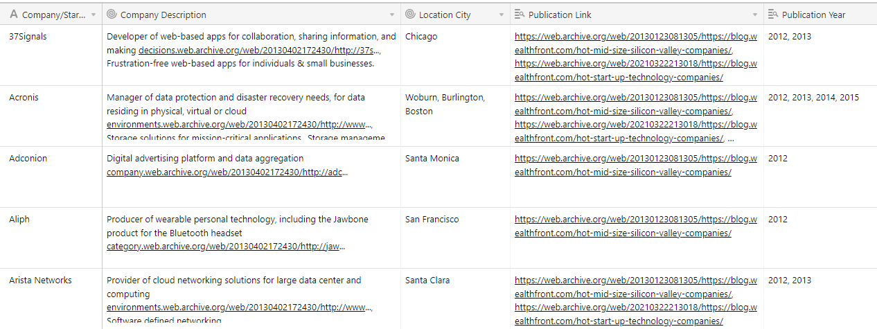

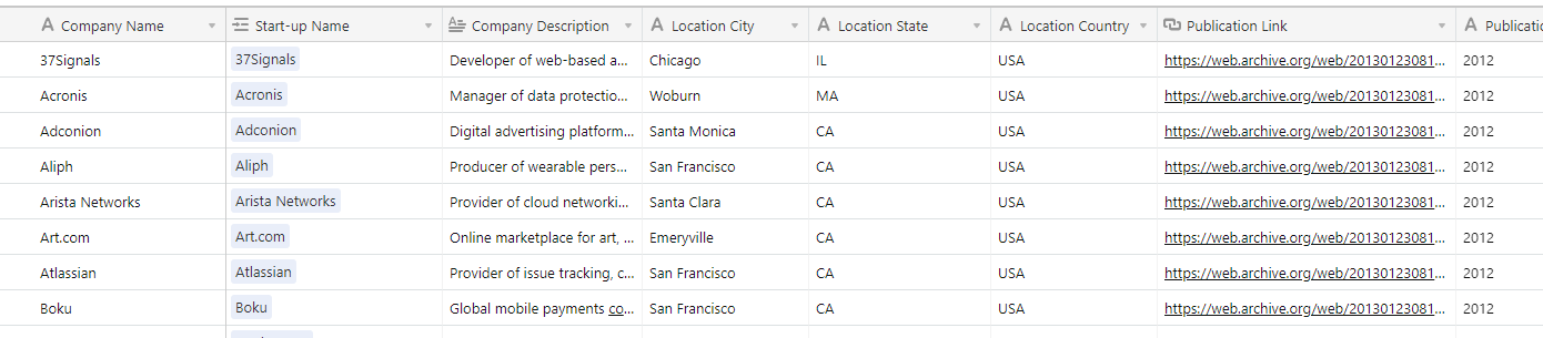

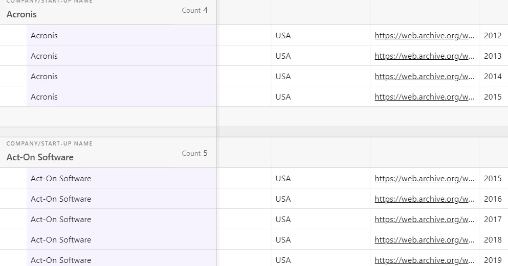

Yeah, I’d be adding more and more data as I collect it. Right now, it is just a list where I can add to excel and copy over to airtable easily.
The second image here was an attempt at hacking together a summary list based on the publication links (end goal is to do what you and I had above ^ Publication link/url is for my own benefit (where I sourced data), Publication Name and Years would be what I wanted listed. But there are many lists still to scrape and sort through.
Let me know if you’re possibly open to chat about it in realtime or discuss via Loom. Primarily the capability/flexibility of what you’d done there as well as being able to add in more data.
