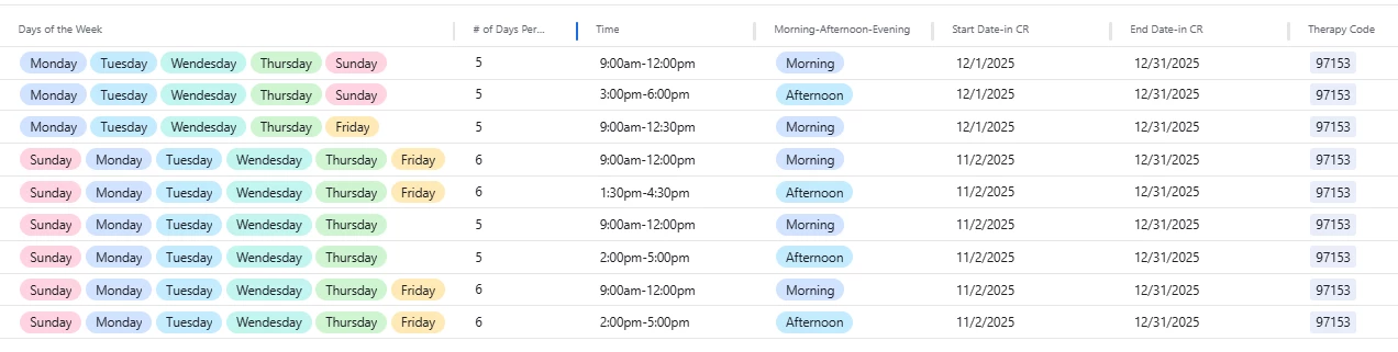

  • Jul 28, 2026 4:55 PM UTC
How about creating a multi-select field with each of the days of the week and then use a text field to log the times of each BT’s availibility.
You can also utilize the calendar view on the interface that will enable easy viewing .
See screenshot of a similar set up that I built for another ABA company.

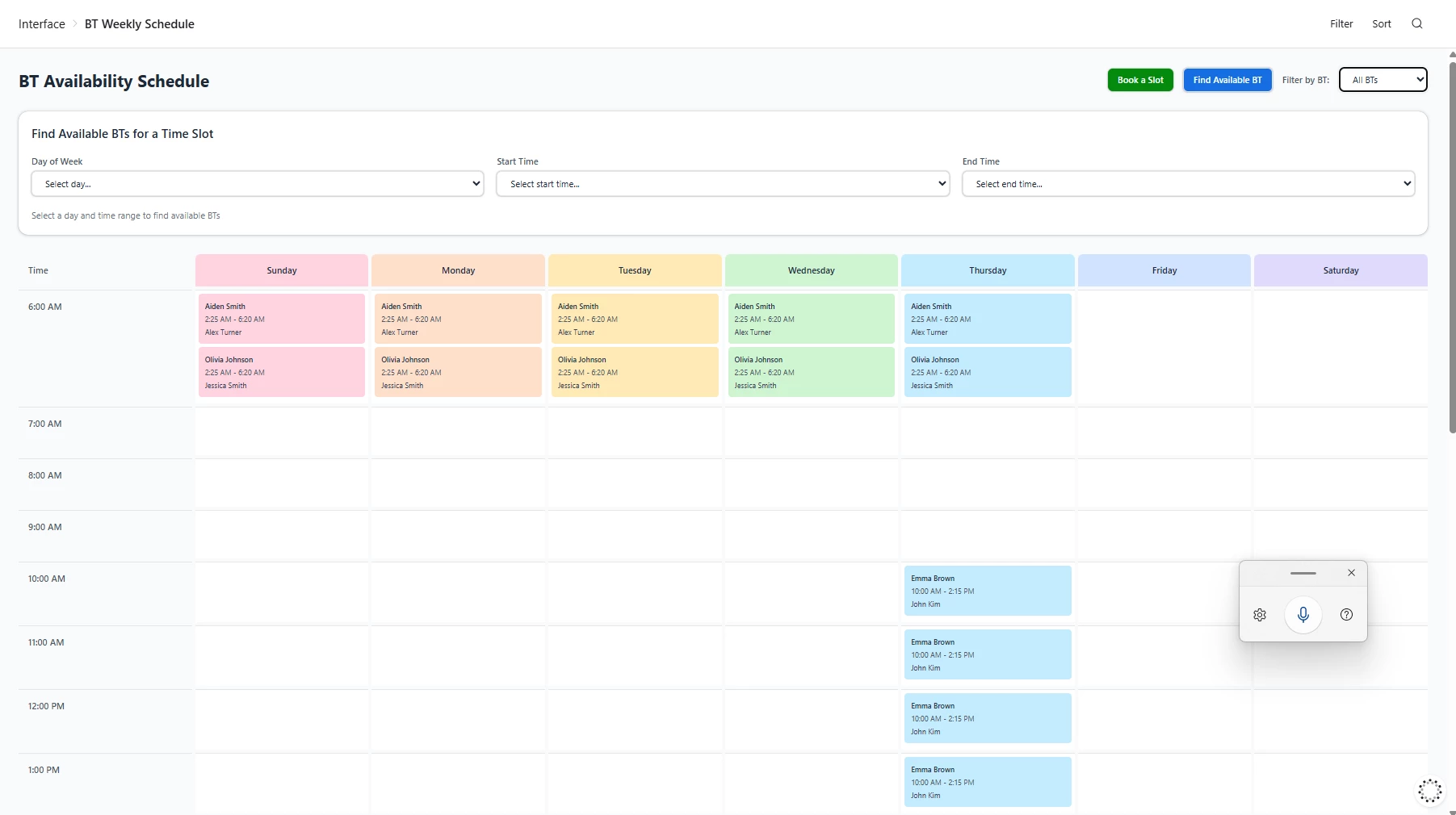

​@Ac_dvlp Thank you I use your data structure instead of a text field four times and make drop downs for every five minutes from the day Here I will share a picture that I make with a new AI builder and on the interface it's very powerful
Ac_dvlp
  • Jul 28, 2026 6:00 PM UTC
Nice work! Looks great!
