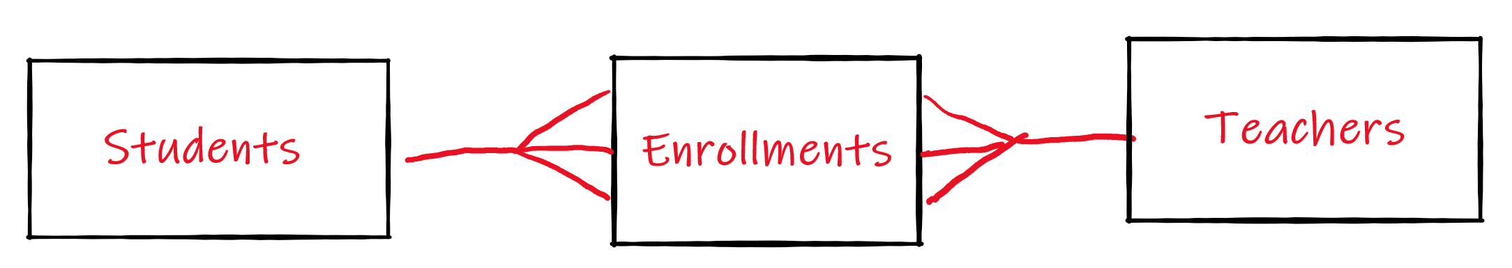

Glad you found it helpful.
Many-to-many relationships are often presented as something advanced and scary. Not really. The classic example for many-to-many is the school enrollment app. You start with Students and Teachers (in two different tables). Then you have a join/junction table typically called Enrollments.
The thing to keep in mind is that any data that pertains, say, to a student regardless of whether that student is enrolled in any classes at all would be stored in fields in the Students table. On the other hand, each record in the Enrollments table represents one student taking a class from one teacher.
So far, it’s actually pretty straightforward — and this might be the situation with your use case.
Of course in real life, the school enrollment example often is NOT this simple. Typically the database will need to have tables for several other fields:
  • Classes: This would solve the problem not uncommon in universities where 1 student might be enrolled in two quite different classes from the same teacher; it also allows for Prof Jones and Prof Smith both to be teaching classes of French 1101.
  • Grades
  • Buildings and Rooms
And so on. So you end up having many-to-many-to-many-etc relationships. Lots of fun!
