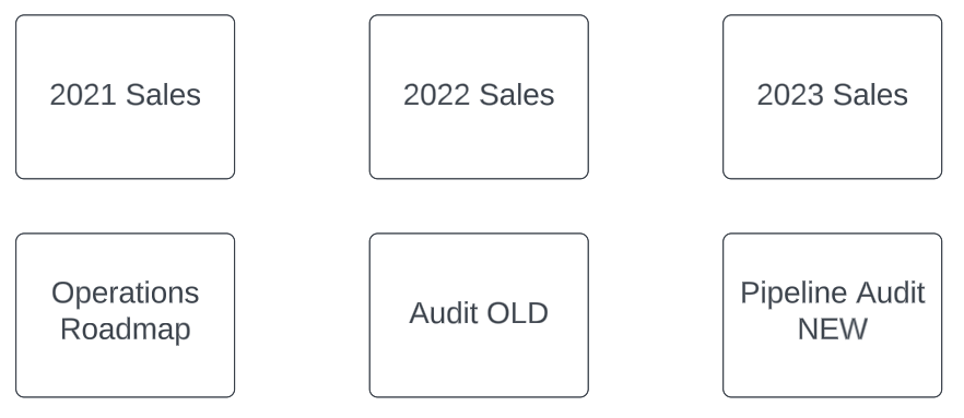

Historically, when I've interacted with users and businesses that were spreadsheet-driven before interacting with Airtable, they end up wanting to mimic their old spreadsheets. This presents in them translating each sheet on their spreadsheet files into a table within Airtable.
I see this a lot.

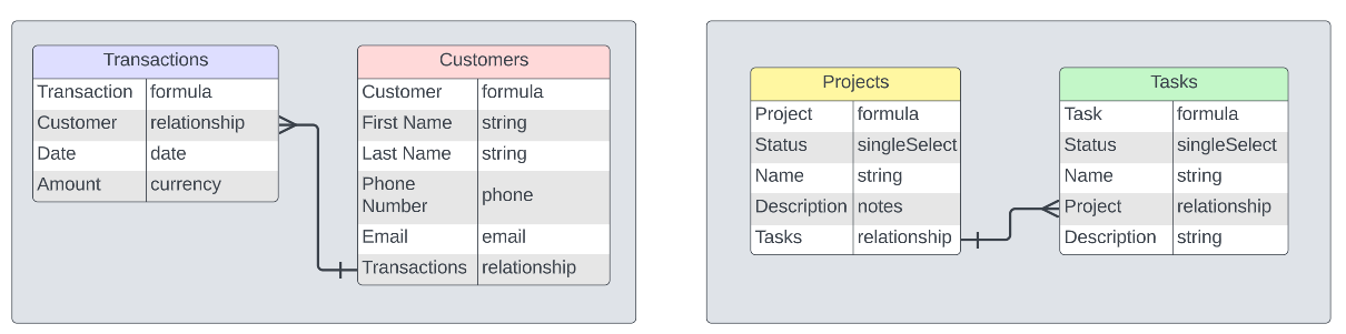

The example tables above can probably be split into two bases. One base for sales, and the other base for project and task management with four clean, concise tables:

That being said, feel free to provide any additional details about your data or what your use case is. I'd be happy to dig in and walk you through how you can better structure your data, because I presume you're at a point where your data is no longer working for you and is probably weighing you down with how bulky it all is.
