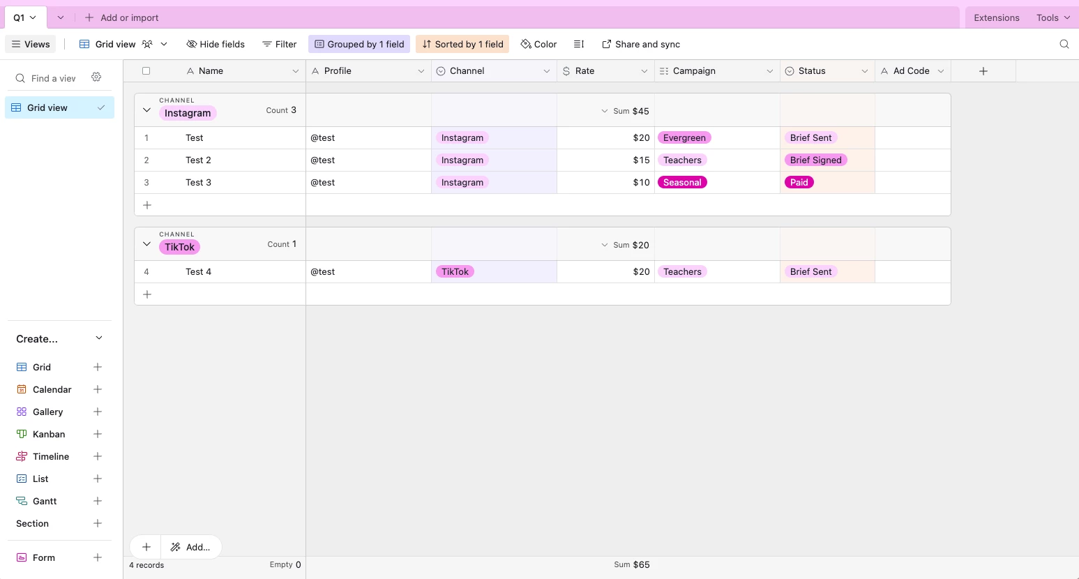

Inspired by a discussion of the same topic on Reddit, here's an alt solution compressing into one table (I can't add screenshots in reply to the Reddit topic).

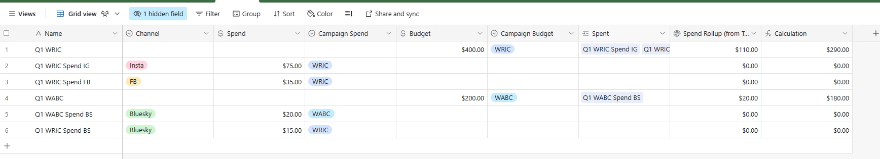

Screenshot 1 is a basic example of the base layout, and you add a self referencing link to the same table, titled here as "Spent". This makes the spending records children of the budget record (so you only use it on budget records). Then you rollup the Spend field, summing values, and finally you add a formula Budget-Spend Rollup.

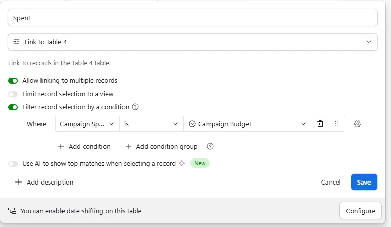

That's the basics, but two other additions can spice this up more. One is making the children records only assignable to the correct budget, using dynamic record filtering. You can see an example in screenshot 2, so only spending records with a matching tag are assignable (and you could expand that by adding more single select fields, for instance making Q1, Q2, Q3, Q4 tags instead).
