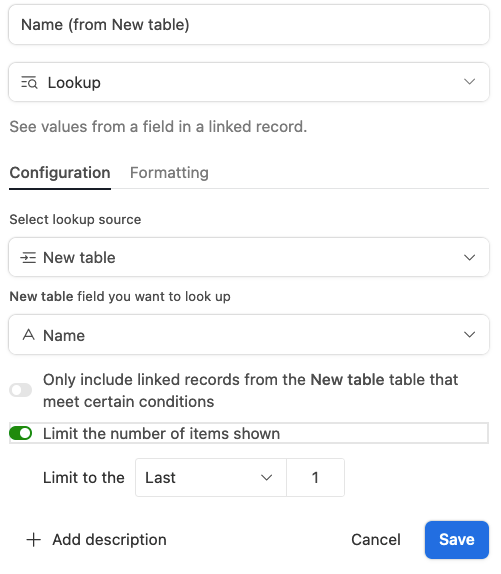

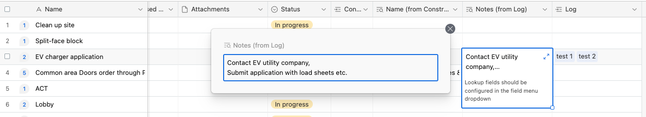

1. My activity log contains a lot of activities for multiple action items. I link them to the main action item through lookups which then it shown on the action items table. Currently it shows ALL the activity logs on that table. Is there a way to limit it to show only the latest one (there are condition but thats very limited)? And can I show multiple columns in the same cell (eg. data logged and notes from the log)? Idea would be to get the latest logs for each action item in the table without clicking and expanding to view more details:
2. Is there a way to leverage forms or an interface on the action items rows to create a new log from within the action items table itself? This would be a better flow since as we review the action items, we can review the log and add another where needed. In some ways, we will be recreating the comments feature but with more granular data management since how we could potentially show specific logs from the activity log using conditions (as long as there's a condition that allows us to filter by date or something)!!

re: Is there a way to limit it to show only the latest one (there are condition but thats very limited)?
Hmm, I'd tackle this with the "Limit to the last" option, but I take it that doesn't work for you?
re: And can I show multiple columns in the same cell
Yeap, in your activity log table create a formula field that consolidates the data from the fields you want, and then create a lookup to that new formula field in your main table
re: Is there a way to leverage forms or an interface on the action items rows to create a new log from within the action items table itself?
Yeap, the idea would be to have some sort of record picker element on your Interface where you select the record you're creating the activity log for.  Once that's available, you can create a Grid / List etc element to display the linked activity logs, and from there you'll be able to easily create new activity log records that are linked to the selected action item, does that make sense?
