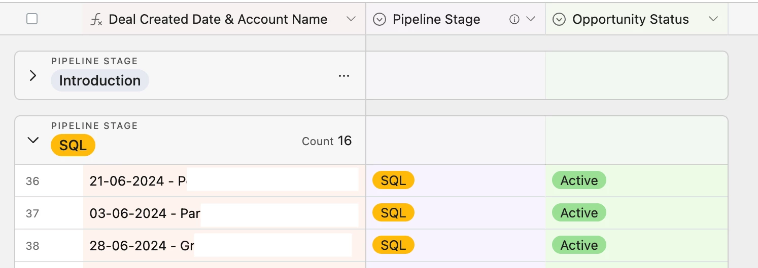

Hmm, when you say separate base I believe you may be referring to a separate table instead?
If so, I've put something together here for how I'd do it
I think I'd just use Count fields instead of rollups actually
How you calculate things is also quite dependent on your business logic.  In the screenshot above, I got the number 62 by counting all the deals that did not have a "Pipeline Status" of "Intro", which implied that they had went past that stage.  I don't know whether that holds up for your workflows though
Similarly, for the "Intro > Qualified (Active)" conversion, I counted all the deals that were "Qualified" that were "Active"

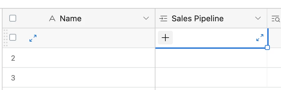

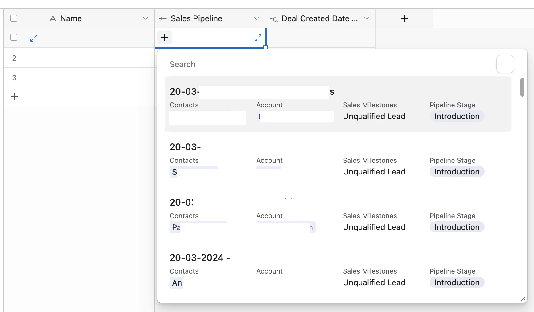

Is there a way to have all opportunities automatically show up in the Linked column? I see that I can manually click to link each one, but what happens when a new Opportunity record comes in?
Once I solve that then I think I can look into trying the Count method, too
thanks appreciate the help!
I'd recommend an automation that triggers when a new Opportunity record comes in, and its action would be to link itself to the Summary record!
